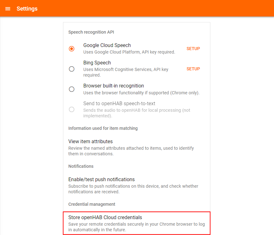

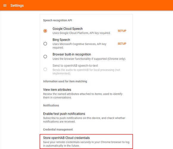

Saving the Remote Credentials
If you’re using Chrome, HABot can leverage the Web Credentials API to avoid having to log in to openHAB Cloud/myopenhab.org: go to the Settings screen from the side bar, and provide your credentials in the dialog box. The browser will ask you if you want to save them in a separate dialog, which you’ll have to confirm - they will be stored locally and securely.
Next time you’re accessing HABot and the credentials are needed, you’ll see a small pop up for a few seconds indicating the saved credentials are being used.
(note: the option doesn’t appear unless you’re using Chrome on a secure origin)
