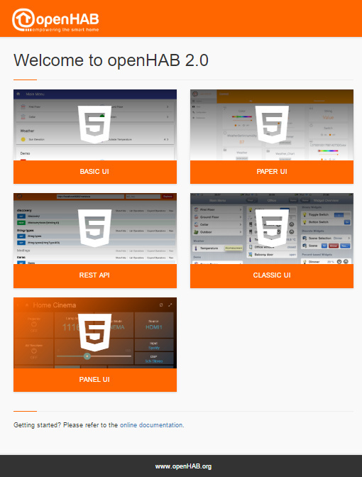

I had a little free time today so I made a proof-of-concept bundle for my alternative GUI project as suggested by Kai :slight_smile:
If you want to check it out, download the .jar here: https://github.com/ghys/openhab2-addons/releases/tag/panelui-2.0.0-SNAPSHOT and drop it into your addons folder. It will install automatically.
Check the logs for:
[INFO ] [b.ui.panelui.internal.PanelUIService] - Started Panel UI at /panelui
It should also appear on the home page dashboard:
Remember, persistence is still restricted to the current browser (in local storage) and not saved on the server at the moment.
