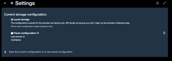

Now I can no longer save to the server. I see this when I go into advanced:

It was empty. I had saved the JSON from the browser I was using and pasted it in there but that didn’t work. Is there a different format for what is preserved there vs in the browser > advanced settings > show local configuration object?
Thanks!!

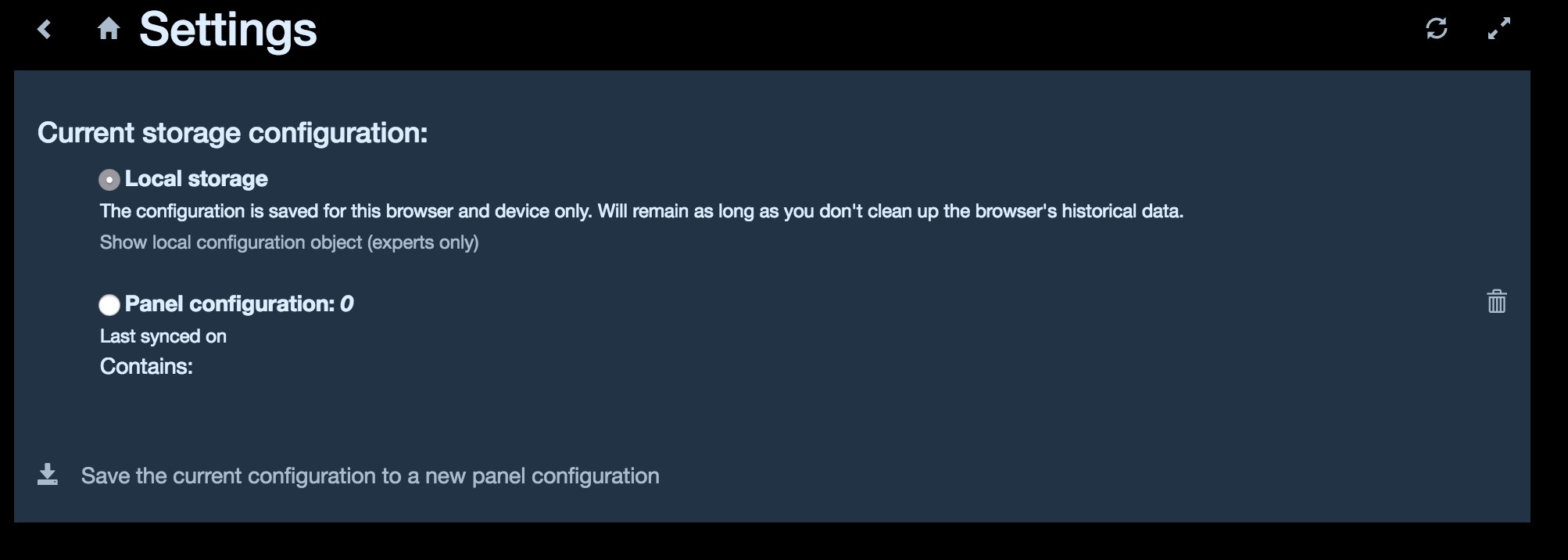

Ah, don’t know why it has been emptied. Good thing you still have your local configuration, simply type
in Paper UI to make sure the server property is properly initialized, then go into the app settings, switch to local storage, paste your local configuration into the “show local configuration object” text box, and finally click on the “save the current configuration to a new panel configuration” link and give it a name.
Wow, that was easy! Server config is stored.

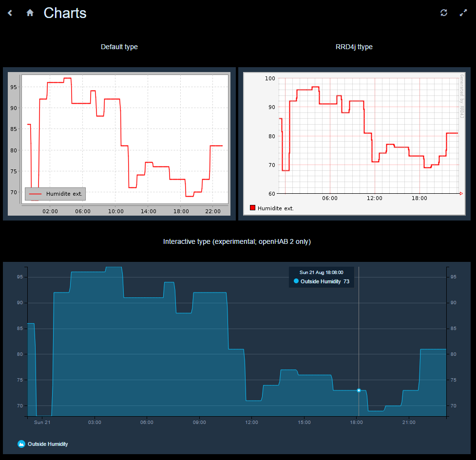

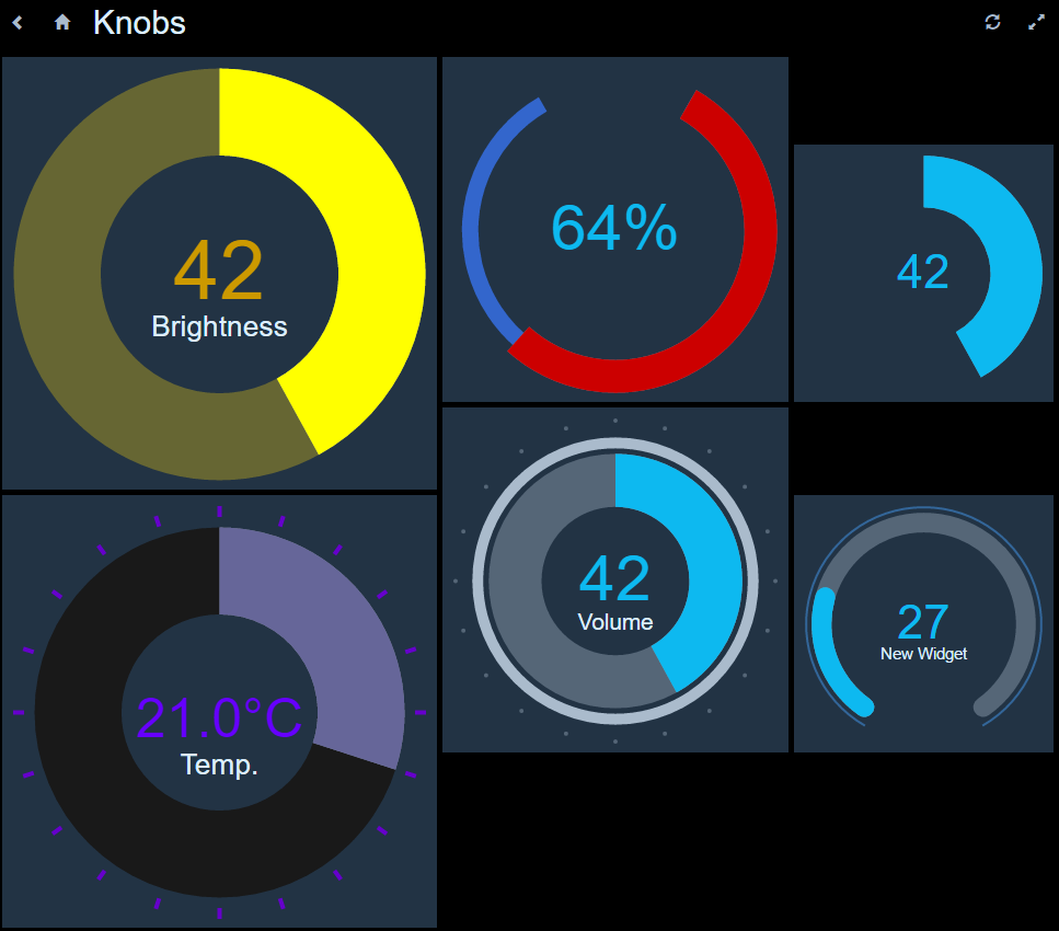

Notably includes (apart from a few fixes, like proper formatting for numerical values) 2 new widget types, Knob and Chart - including fancy new (experimental) interactive charts consuming openHAB 2’s persistence API endpoint!
Obligatory shout out to the libraries used for these:
Excellent, very nice work. The charting is very nice indeed. At this rate i’m going to be moving from my BasicUI setup to HabPanel sooner than I thought.
One comment, when using the server provided format you might like to also disable the HabPanel Unit or it gets duplicated. I’m not sure if there are cases where you would want to add another unit though, so perhaps best to leave as-is.

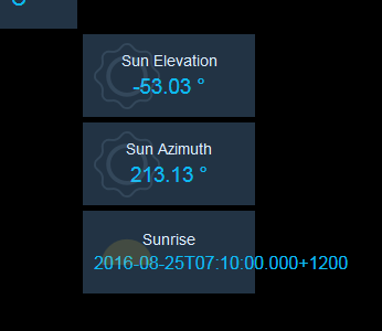

What is the correct syntax to use in the format field on the dummy widget for date & time.
Following is what I currently get for “sunrise”, which is the same as the Basic UI after the first screen refresh.
Ideally, I just want to display… 07:10
Thanks,
Mike
A little code change is needed so DateTime items are parsed properly, like Paper UI. Can’t make it now, probably in a few days. Can you open an issue on GitHub so it’s tracked properly? Thanks
