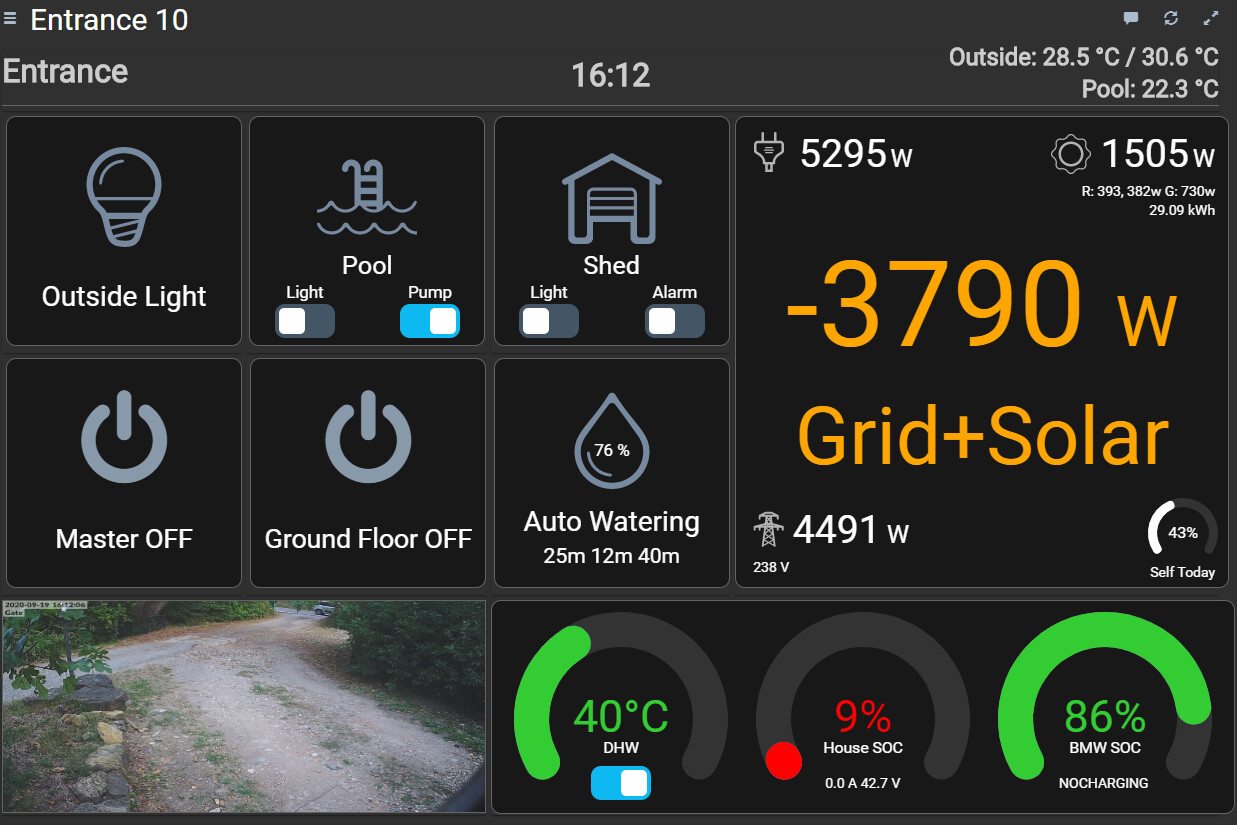

Great example I have the same setup and just copied it.
One thing that I now have in mind would be getting the popup modal on demand when some OH item changes, (additionally to the tumbnail click) So the when unknown car stops at the gate or intercom button is pressed it is already poped up (on my tablet that takes 1-2 seconds)
Anyone has any idea how to do it as my HTML skills are lacking, and I would need some example to build uppon.
Use this widget.
