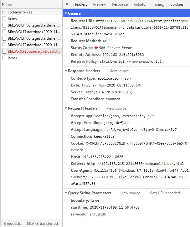

HabPanel, widget TimeLine does not display data from the database influxdb2.
chrome - developer tools:
REST API:
http://192.168.215.221:8080/rest/persistence/items/BlitzWOLF?serviceId=influxdb

So if I understand correctly, this request works:
but this one doesn’t:
What if you include the starttime but not boundary=true? What do you have in the response tab to this call? Sometimes you have more information there.

http://192.168.215.231:8080/rest/persistence/items/Box_HeaterIR?boundary=true&starttime=2020-12-12T08:42:48.654Z&serviceId=influxdb
result:
"{\"error\":{\"message\":\"error in building plan while starting program: cannot query an empty range\",\"http-code\":500,\"exception\":{\"class\":\"com.influxdb.exceptions.BadRequestException\",\"message\":\"error in building plan while starting program: cannot query an empty range\",\"localized-message\":\"error in building plan while starting program: cannot query an empty range\"}}}"
and
http://192.168.215.231:8080/rest/persistence/items/Box_HeaterIR?starttime=2020-12-12T08:42:48.654Z&serviceId=influxdb
result:
{"name":"Box_HeaterIR","datapoints":"11","data":[{"time":1607770382301,"state":"OFF"},{"time":1607825001651,"state":"OFF"},{"time":1607825001651,"state":"ON"},{"time":1607855715531,"state":"ON"},{"time":1607855715531,"state":"OFF"},{"time":1607911899651,"state":"OFF"},{"time":1607911899651,"state":"ON"},{"time":1607952782902,"state":"ON"},{"time":1607952782902,"state":"OFF"},{"time":1608000847119,"state":"OFF"},{"time":1608000847119,"state":"ON"}]}
strange, for some reason 2-ON, then 2-OFF.

preview:
responce:
What does this mean? What can I do to get this to work?
That’s what you did above - when you have boundary=true in the request, it doesn’t work, you get this: error in building plan while starting program: cannot query an empty range.
It appears to be a bug in the influxdb persistence service, you should open an issue on GitHub to have it fixed.
