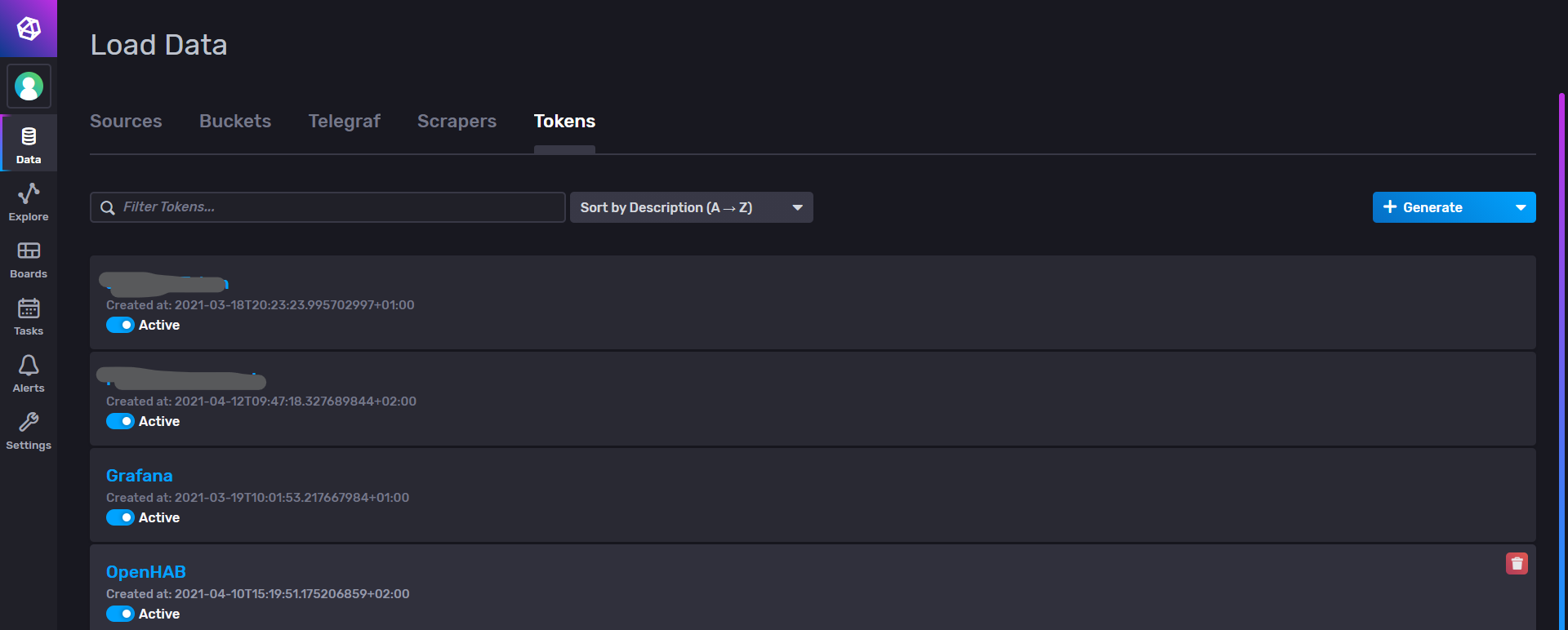

No, the web interface is actually really convenient!
Just remember to grant openhab both read and write access.
@pacive - I missed that my bad :blush: … of course you are right. Anyway I have done it via CLI and so far so good everything works.
Just wanted to confirm here after over a month by now, all works without any disruptions and problems. So switching from user/pwd to token made the trick. Thank you @pacive one more time for help!
