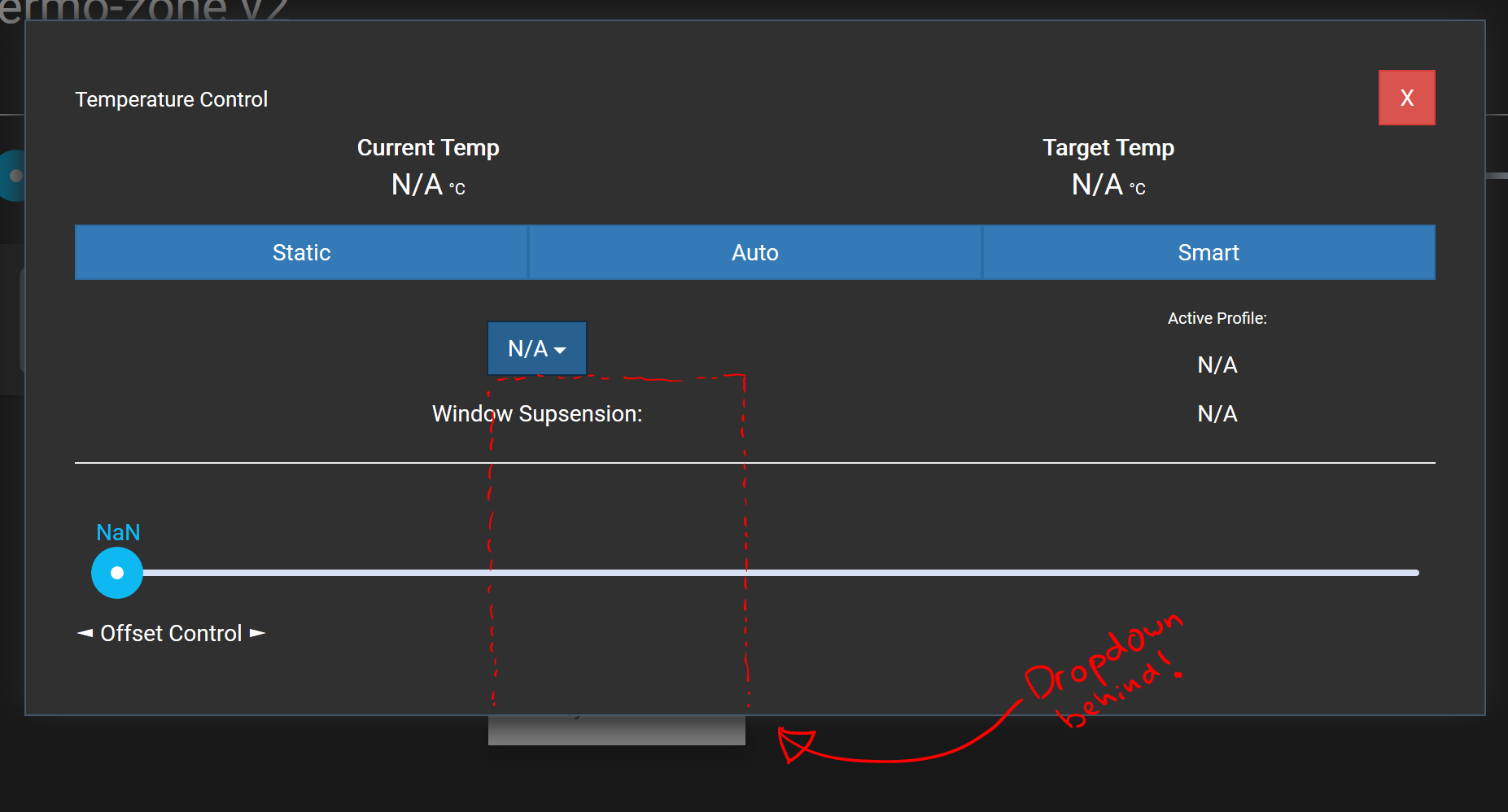

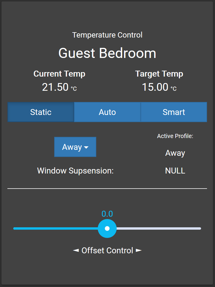

I’m developing a pop-up variant of a widget that I use to control the heating in each room/zone via HabPanel. Here’s how it looks as a non-popup widget:
When I use it as a widget, it functions fine–all the buttons work, I can adjust the slider, and use the dropdown to select the active profile. Unfortunately, when I try to put this widget in a pop-up, the drop-down menu choices appear underneath the popup:
Anyone know how to fix this? I assume it’s a simple CSS issue, but I can’t figure it out. Here’s my widget code:

I’ve tried adding a very high z-index to the style at multiple places, but no matter how high I set it, the dropdown choices still appear behind the popup. I suspect that the popup is somehow above all the z-indexes
Alright, I’ve fixed it using this stackexchange post.
