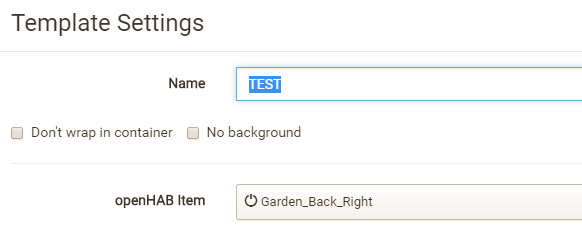

I was just wonderring; instead of me starting to create a new widget everytime I make a new switch, wouldn’t it then be possible to change the items names I have with a Variable or so, that from the HabPanel configuration view would allow me to locate all my items? Just like when addind a normal switch to a panel?
Like this:
Any suggestions?

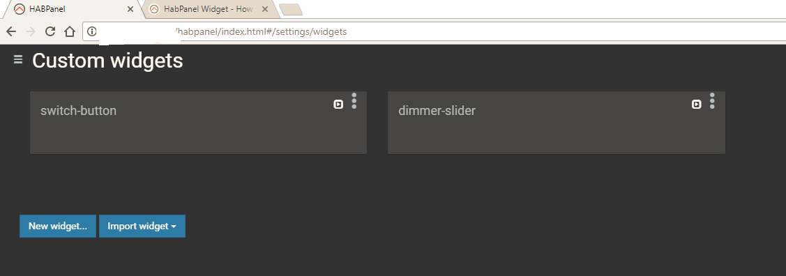

@Yoinkz seems to me you are using a template widget and putting your stuff there. What you need to do is create an actual custom widget:
http://YOUROPENHAB/habpanel/index.html#/settings/widgets

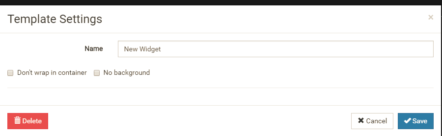

@luckymallari I’m sorry if I’m not doint it the right way, but I was under custom widgets and created the buttons in widget in there:
The code is taken from;
Location of the CSS for editing the dummy and switch looks - #4 by xsherlock with thanks from @xsherlock, and pasted into a new widget I created. But when changing the Item value as described above, nothing happens :(.

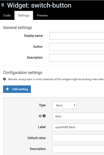

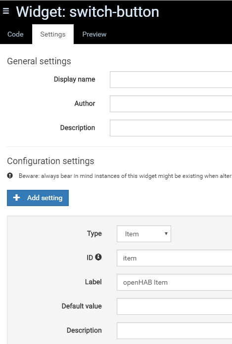

@Yoinkz please read my post the above and the second link, you have to add a setting to the widget.
In the screen where you pasted the code, go to the Settings tab, click Add setting, and choose Item as the type and “item” as the ID.
Don’t forget to save with the green button on the right.
You can click on the Preview tab and on the image icon in the corner to show the settings dialog box and verify your setting is there.
@ysc, EXACTLY.

Seems be working great! One last thing - is it possible to grab the Name that you type when editing template settings?
Before I manually entered the Text that I wanted to show here:
