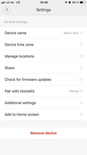

did someone of u connect the Aqara Gateway to OpenHab? The Way with about in the mi Home App doesn‘t work. Look at the Picture. The First strugle with binding it to the mi Home App is fixed. But for this Problem i found mi Solution.
For the old Gateway ist solved with the Developer Mode. But i Cano activ it.

It seems that the new version of this Mi Home App does not have the option to enable Developer mode (or no-one has found it yet) :slight_smile:
Looks like. I hope someone will find this out… i work with Homekit but the possibilitys with Openhab is endless. I wrote the Aqara Support, waiting für there answer.

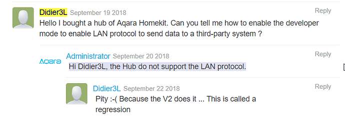

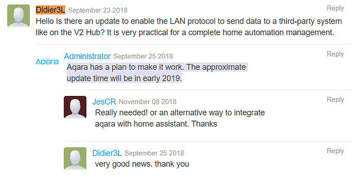

Sadly it doesnt work jet. Try to inform them there that you also wann this Funktion. https://community.aqara.com/forum/faq-1/topic/how-to-connect-the-aqara-hub-to-the-network-78
