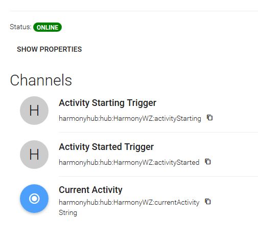

Yes, works fine, just tried it (did not even know this triggers exists).
29-Sep-2017 13:45:17.166 [INFO ] [org.eclipse.smarthome.model.script.EXTRA          ] - HARMONY: Hub is going off...
29-Sep-2017 13:46:05.225 [INFO ] [org.eclipse.smarthome.model.script.EXTRA          ] - HARMONY: TV is starting...
29-Sep-2017 13:46:27.084 [INFO ] [org.eclipse.smarthome.model.script.EXTRA          ] - HARMONY: TV is started
29-Sep-2017 13:47:15.551 [INFO ] [org.eclipse.smarthome.model.script.EXTRA          ] - HARMONY: Hub is going off...
rules:
rule "Starting TV"
    Channel "harmonyhub:hub:HarmonyWZ:activityStarting" triggered TV_mit_Bose
    logInfo("EXTRA", "HARMONY: TV is starting...")
rule "TV started"
    Channel "harmonyhub:hub:HarmonyWZ:activityStarted" triggered TV_mit_Bose
    logInfo("EXTRA", "HARMONY: TV is started")
rule "Going off"
    Channel "harmonyhub:hub:HarmonyWZ:activityStarting" triggered PowerOff
    logInfo("EXTRA", "HARMONY: Hub is going off...")
rule "Hub off"
    Channel "harmonyhub:hub:HarmonyWZ:activityStarted" triggered PowerOff
    logInfo("EXTRA", "HARMONY: Hub is off - no activity")
Note that if you have spaces in your Harmony sketch name you have to escape them with underscores:
TV mit Bose from Harmony hub becomes
TV_mit_Bose in your rule.

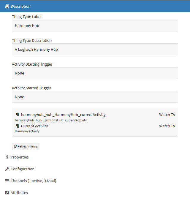

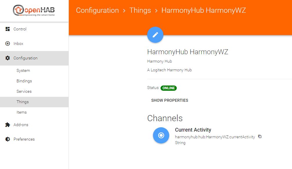

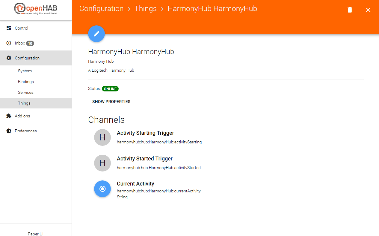

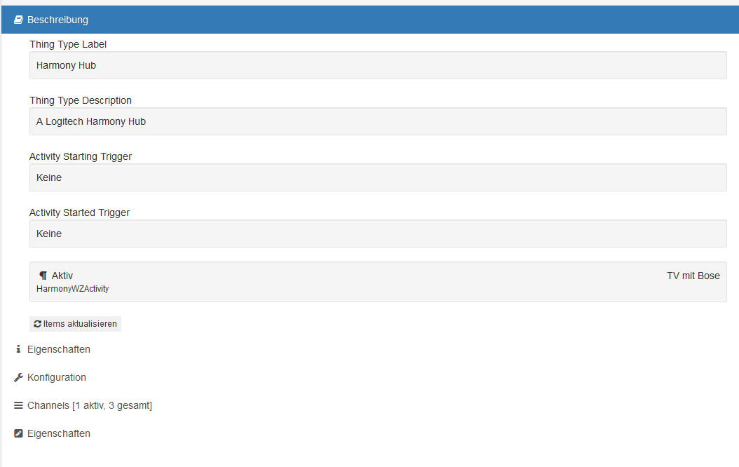

Could you please check your HarmonyHub thing configuration screen and see if it matches mine? Are the two triggers just represented with the gray circled H or are they the blue circled “switch” like the currentActivity channel?
The funny thing is, those are not shown at all in my setup:
I’m on snapshot 2.2 build #1050, harmony binding is
208 │ Active │ 80 │ 2.2.0.201709272129 │ HarmonyHub Binding
I can’t remember any new system settings which could cause this …
I’m currently running snapshot 2.2 build #1054 and the harmony binding is:
205 │ Active │ 80 │ 2.2.0.201709301515 │ HarmonyHub Binding
I’ve been trying to get this working since build #1047 and various binding versions and nothing seems to change between versions.

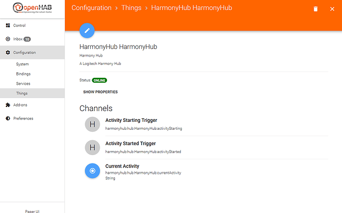

Then I noticed the thing name is out of sync with the Channels in the PaperUI. The name is displayed as:
HarmonyHub HarmonyMain
while the channels still display:
harmonyhub:hub:HarmonyHub:activityStarting
harmonyhub:hub:HarmonyHub:activityStarted
harmonyhub:hub:HarmonyHub:currentActivity
Next time I work on this I’m going to have to delete the things and binding and start from scratch again.

Still doesn’t work for me. I use the current snapshot every time I’ve attempted to install the binding. I’ve created at least 6 different VMs using different OS’s and java versions to no avail.
Every single time the triggers show up listed under Channels in PaperUI. I’m convinced that so long as they show up there they will not function properly. I can’t say why.
As far as following the docs:
Install binding via PaperUI
Add thing.
Add rules.
CurrentActivity works, neither trigger does. :confounded:

@sihui I was wondering if you could possibly check your Harmony Hub thing in Habmin and see if your Starting and Started triggers indicate “None”?
Thanks!
Sure. They indicate “Keine” = None
BTW, is there any reason why you have two items linked to the currentActivity channel?
