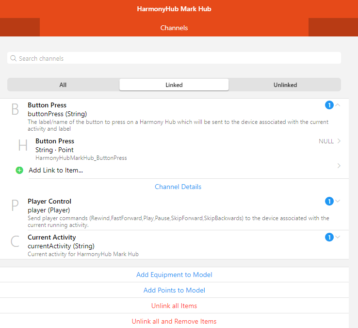

This is a very cool widget and provides excellent functionality, so I decided to try and expand it to match my Harmony Elite remote. I have however come across some stumbling blocks related to the support of all the buttons.
As per the binding documentation the following button press values are supported:
Mute,VolumeDown,VolumeUp,DirectionDown,DirectionLeft,DirectionRight,DirectionUp,Select,Stop,Play,Rewind,Pause,FastForward,SkipBackward,SkipForward,Menu,Back,Home,SelectGame,PageDown,PageUp,Aspect,Display,Search,Cross,Circle,Square,Triangle,PS,Info,NumberEnter,Hyphen,Number0,Number1,Number2,Number3,Number4,Number5,Number6,Number7,Number8,Number9,PrevChannel,ChannelDown,ChannelUp,Record,FrameAdvance,C,B,D,A,Live,ThumbsDown,ThumbsUp,TiVo,WiiA,WiiB,Guide,Clear,Green,Red,Blue,Yellow,Dot,Return,Favorite,Exit,Sleep
And the latest list of supported values can be found by:
A complete list of names for device buttons values can be determined via the REST API for channel-types, http://YourServer:8080/rest/channel-types (opens new window). Search the JSON for “harmonyhub:device”.
I have tried to access the list using the API Explorer on OH3.0 but I am not able to find the list of supported values. I am able to see the channels etc on my Hub.
I have tried to use the “supported” colour buttons (Red, Green, Yellow and Blue), but get no response from the HarmonyHub.
The widget “button” is working as I get a response if I send a “working” command (such as Menu)to the Hub. If I send “Red” I get no response:

So I have done some further testing etc and debugging with the following:
log:set TRACE com.digitaldan.harmony
So If I send Info to the HarmonyHub I get the following:
19:03:47.938 [TRACE] [ub.internal.handler.HarmonyHubHandler] - Handling command 'Info' for harmonyhub:hub:MarkHub:buttonPress
19:03:47.953 [DEBUG] [com.digitaldan.harmony.HarmonyClient ] - Sending: {"hbus":{"cmd":"vnd.logitech.harmony/vnd.logitech.harmony.engine?holdAction","id":"dc3b38ab-9883-47c9-b808-ddc074627ef7","params":{"action":"{\"type\":\"IRCommand\",\"deviceId\":\"60277394\",\"command\":\"Info\"}","status":"press","timestamp":44875259}}}
19:03:47.953 [TRACE] [com.digitaldan.harmony.HarmonyClient ] - writeSuccess for message dc3b38ab-9883-47c9-b808-ddc074627ef7
19:03:48.156 [DEBUG] [com.digitaldan.harmony.HarmonyClient ] - Sending: {"hbus":{"cmd":"vnd.logitech.harmony/vnd.logitech.harmony.engine?holdAction","id":"5b7d2a4f-687c-497e-8d87-acc0cd54d24b","params":{"action":"{\"type\":\"IRCommand\",\"deviceId\":\"60277394\",\"command\":\"Info\"}","status":"release","timestamp":44875462}}}
19:03:48.156 [TRACE] [com.digitaldan.harmony.HarmonyClient ] - writeSuccess for message 5b7d2a4f-687c-497e-8d87-acc0cd54d24b
If I send Red I get:
19:04:19.559 [TRACE] [ub.internal.handler.HarmonyHubHandler] - Handling command 'red' for harmonyhub:hub:MarkHub:buttonPress
19:04:19.559 [DEBUG] [com.digitaldan.harmony.HarmonyClient ] - Sending: {"hbus":{"cmd":"vnd.logitech.harmony/vnd.logitech.harmony.engine?holdAction","id":"c209725f-d99e-417f-b1c4-c3f24145ea9b","params":{"action":"{\"type\":\"IRCommand\",\"deviceId\":\"60277394\",\"command\":\"Red\"}","status":"press","timestamp":44906865}}}
19:04:19.559 [TRACE] [com.digitaldan.harmony.HarmonyClient ] - writeSuccess for message c209725f-d99e-417f-b1c4-c3f24145ea9b
19:04:19.764 [DEBUG] [com.digitaldan.harmony.HarmonyClient ] - Sending: {"hbus":{"cmd":"vnd.logitech.harmony/vnd.logitech.harmony.engine?holdAction","id":"321225bd-bd9d-42c2-9a56-f5acfa85c7d9","params":{"action":"{\"type\":\"IRCommand\",\"deviceId\":\"60277394\",\"command\":\"Red\"}","status":"release","timestamp":44907070}}}
19:04:19.764 [TRACE] [com.digitaldan.harmony.HarmonyClient ] - writeSuccess for message 321225bd-bd9d-42c2-9a56-f5acfa85c7d9
Which look like both commands are working.
I also noted that when sending the colour commands to the Hub, the Green LED does flash to indicate a command received.
However the Red command works on the Remote, but not via the HarmonyHub Binding for some reason.
If I assign a different value (such as Info etc) to the Red button on the Widget, that value works. So issue seems to be specific to the colour Keys.
Wonder if this is similar to what @Craigers mentioned here regarding the DVR button -
@Craigers also confirmed that my edited Widget seems to work on his setup using the colour buttons, so I am now at a loss for what else to try.

I am sending the command to the Hub. So sending Red, which on my remote brings up the Playlist of my currently active device if I use the remote. However when sending the command via OpenHab / Harmony Hub Binding I see the light on the hub flash - indicating something has been received, however nothing actually happens on the device. Also, if I send the buttonPress of any other button it seems to work as expected. So Info brings up Info, Mute brings Mutes etc.
Harmony Hub Thing:
UID: harmonyhub:hub:MarkHub
label: HarmonyHub Mark Hub
thingTypeUID: harmonyhub:hub
configuration:
  host: 10.163.199.245
  heartBeatInterval: 30
From Rest API:
  "statusInfo": {
    "status": "ONLINE",
    "statusDetail": "NONE"
  "editable": true,
  "label": "HarmonyHub Mark Hub",
  "configuration": {
    "host": "10.163.199.245",
    "heartBeatInterval": 30
  "properties": {
    "name": "Mark Hub"
  "UID": "harmonyhub:hub:MarkHub",
  "thingTypeUID": "harmonyhub:hub",
  "channels": [
      "linkedItems": [],
      "uid": "harmonyhub:hub:MarkHub:activityStarting",
      "id": "activityStarting",
      "channelTypeUID": "harmonyhub:eventTrigger",
      "kind": "TRIGGER",
      "label": "Activity Starting Trigger",
      "description": "Triggered when an activity is starting",
      "defaultTags": [],
      "properties": {},
      "configuration": {}
      "linkedItems": [],
      "uid": "harmonyhub:hub:MarkHub:activityStarted",
      "id": "activityStarted",
      "kind": "TRIGGER",
      "label": "Activity Started Trigger",
      "description": "Triggered when an activity is started",
      "defaultTags": [],
      "properties": {},
      "configuration": {}
      "linkedItems": [
        "HarmonyHubMarkHub_ButtonPress"
      "uid": "harmonyhub:hub:MarkHub:buttonPress",
      "id": "buttonPress",
      "channelTypeUID": "harmonyhub:buttonPress",
      "itemType": "String",
      "kind": "STATE",
      "label": "Button Press",
      "description": "The label/name of the button to press on a Harmony Hub which will be sent to the device associated with the current activity and label",
      "defaultTags": [],
      "properties": {},
      "configuration": {}
      "linkedItems": [
        "HarmonyHubMarkHub_PlayerControl"
      "uid": "harmonyhub:hub:MarkHub:player",
      "id": "player",
      "channelTypeUID": "harmonyhub:player",
      "itemType": "Player",
      "kind": "STATE",
      "label": "Player Control",
      "description": "Send player commands (Rewind,FastForward,Play,Pause,SkipForward,SkipBackwards) to the device associated with the current running activity.",
      "defaultTags": [],
      "properties": {},
      "configuration": {}
      "linkedItems": [
        "HarmonyHubMarkHub_CurrentActivity"
      "uid": "harmonyhub:hub:MarkHub:currentActivity",
      "id": "currentActivity",
      "channelTypeUID": "harmonyhub:hub:MarkHub:currentActivity",
      "kind": "STATE",
      "defaultTags": [],
      "properties": {},
      "configuration": {}
Not sure how to get you the item configuration as it is all internal.
EDIT: From RestAPI:
  "link": "http://localhost:8080/rest/items/HarmonyHubMarkHub_ButtonPress",
  "state": "NULL",
  "stateDescription": {
    "pattern": "%s",
    "readOnly": false,
    "options": []
  "editable": true,
  "type": "String",
  "name": "HarmonyHubMarkHub_ButtonPress",
  "category": "",
  "tags": [
    "Point"
  "groupNames": [
    "HarmonyHubMarkHub"
I have downloaded the full JSON string when the binding restarts and can see the colour buttons in the JSON. I do however not see any commands that look like they would be for the Home Control buttons on the Harmony Elite remote.
Also appears that the binding is sending something to the hub as per the Trace logs I posted.
How do you retrieve this?
As I mentioned I have logged this with Logitech/Harmony and they asked for a set of logs as it appears that something is getting sent to the Hub - they are just taking quite some time to respond.
Appreciate you help
Mark
Sorry, maybe i misunderstood, are we talking about the colors or home control buttons? The Home control buttons are not part of the API we use, or at least were not when i wrote this binding (i have not checked in a while).
If you can enable TRACE logging for the underlying websocket client, we can get a raw output of the devices and commands that are supported , you can do this in the OH console with
Then pause and un-pause the thing from the UI and take a look at the logs. You will see a VERY long json message there, feel free to PM me the content.

My query/issue is twofold.
Firstly I am unable to get the Color buttons to work via the binding. Initially I thought the commands were not supported by the binding, based on the documentation, With subsequent investigation however I have discovered that they are supported and it appears that something is being sent to the Hub. However no action occurs on the Hub - even though the same command sent via the actualy remote works 100%
Secondly I am trying to access the Home Control functions via OpenHab. These as you said may not be supported by the API?

The active activity is “Explorer Ultra” and the device that is configured to receive the Red command on the hub is the DSTV Explora Ultra.
Not sure if this helps clarify? I amended one of my rules as follows:
rule "Turn OFF Activities "
  Item Harmony_Power_Off received command OFF
  //HarmonyHubMarkHub_CurrentActivity.sendCommand("PowerOff")
  //HarmonyHubMarkHub_ButtonPress.sendCommand("Red")
    DSTVUltraMode1_SendButtonPress.sendCommand("Red")
For either the Hub or the Device if I send “Info” I get the required result. For either if I send “Red” I get no result other than a flash of the LED on the Hub.
