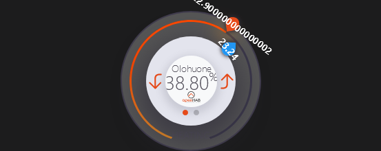

Many thanks for this great widget. I’m also having this same issue with rounding the setpoint value. I’m using %.1f °C pattern in the stateDescription of this item. I tried to use .displayState instead of .state but I managed to screw up the widget so I wonder where to make this change.
Another question, where can I change the size of the text for the humidity (38.80%)?
My code for the widget is:

                                  - component: Label
                                      text: Heating
                      - component: f7-block

                                        text-align: center
                                      default:
                                        - component: Label
                                            text: =items[props.currentPointItem].state.split(' ')[0]
                                            style:
                                              font-size: "=props.fontSizeMarker ? props.fontSizeMarker : '1em'"
                                              color: white
                                              font-weight: bold
                          class: markerContainer
                          style:
                            pointer-events: none
                            margin-top: 0px
                            position: absolute
                            top: 50%
                            left: 50%
                            transform: "=(items[props.setPointItem].state.split(' ')[0] >= Number(props.minTemp) && items[props.setPointItem].state.split(' ')[0] <= Number(props.maxTemp) ? 'translate(-50%, -50%) rotate('+(320/(Number(props.maxTemp)-Number(props.minTemp))*(items[props.setPointItem].state.split(' ')[0]-Number(props.minTemp))-160)+'deg)' : 'translate(-50%, -50%) rotate(0deg)')"
                            width: "=props.size ? (Number(props.size)*0.1) +'px' : '10%'"
                            height: 100%
                            text-align: center
                            transition: 0.7s ease
                            opacity: 1
                            z-index: 99 !important
                          default:
                                class: markerSet
                                style:
                                  margin-top: 0px
                                  width: "=props.size ? (Number(props.size)*0.1) +'px' : '100%'"
                                  height: "=props.size ? (Number(props.size)*0.1) +'px' : ''"
                                  padding-top: "=props.size ? '' : '100%'"
                                  background: "=props.colorSetMarker ? props.colorSetMarker : 'rgb(230, 74, 25)'"
                                  position: absolute
                                  transform: translate(-50%,-50%) rotate(-45deg)
                                  left: 50%
                                  top: "=props.size ?  (Number(props.size)*Number(-0.0125)) +'px': '-2%'"
                                  border-radius: 50% 50% 50% 0
                                  box-shadow: 0 0 5px 1px rgb(48, 46, 56)
                                  z-index: 100 !important
                                default:
                                      class: number
                                      style:
                                        margin-top: 0px
                                        position: absolute
                                        top: 50%
                                        left: 50%
                                        transform: translate(-50%, -50%) rotate(45deg)
                                        text-align: center
                                      default:
                                        - component: Label
                                            text: =items[props.setPointItem].state.split(' ')[0]
                                            style:
                                              color: white
                                              font-weight: bold

                                                        default:
                                                          - component: Label
                                                              text: =props.location
                                                    - component: f7-swiper
                                                        scrollbar: false
                                                        params:
                                                          autoplay:
                                                            delay: 1500
                                                            disableOnInteraction: false
                                                          slidesPerView: 1
                                                          direction: vertical
                                                          mousewheel: true
                                                        style:
                                                          width: 100%
                                                          height: 100%
                                                          position: absolute
                                                          top: 50%
                                                          left: 50%
                                                          border-radius: 50%
                                                        default:
                                                          - component: f7-swiper-slide
                                                              style:
                                                                display: "=props.humItem ? '' : 'none'"
                                                              default:
                                                                    class: heat
                                                                    style:
                                                                      margin-top: 0
                                                                      font-size: "=props.fontSizeCenter ? props.fontSizeCenter : '2em'"
                                                                      color: "=props.colorTypo ? props.colorTypo : 'rgb(87, 84, 95)'"
                                                                      font-weight: 300
                                                                      position: absolute
                                                                      top: 50%
                                                                      left: 50%
                                                                      display: flex
                                                                    default:
                                                                      - component: Label
                                                                          text: =items[props.humItem].state
                                                                      - component: Label
                                                                          text: =items[props.humItem].displayState.split(' ')[1]
                                                                          style:
                                                                            font-size: "=props.fontSizeCenter ? 'calc(' + props.fontSizeCenter + ' * 0.2 )' : '0.6em'"
                                                                            vertical-align: top
                                                              style:
                                                                display: "=props.currentPointItem ? '' : 'none'"
                                                              default:
                                                                    class: heat
                                                                    style:
                                                                      margin-top: 0
                                                                      font-weight: 300
                                                                      position: absolute
                                                                      top: 50%
                                                                      left: 50%
                                                                      display: flex
                                                                    default:
                                                                      - component: Label
                                                                          text: =Number(items[props.currentPointItem].state).toFixed(1)
                                                                      - component: Label
                                                                          text: "=props.unit ? props.unit : items[props.currentPointItem].displayState.split(' ')[1]"
                                                                          style:
                                                                            vertical-align: top
                                                    - component: oh-image
                                                        url: "=props.imgUrl ? props.imgUrl : 'https://community-openhab-org.s3-eu-central-1.amazonaws.com/original/2X/7/7d388a86c95471f89b1bb911d96d7609a3e3a059.svg'"
                                                        style:
                                                          position: absolute
                                                          transform: translate(-50%)
                                                          left: 50%
                                                          bottom: 5%
                                                          width: 40%
                                      style:
                                        width: 100%
                                        height: 100%
                                        display: "=props.chartSwitch ? '' : 'none'"
                                      default:
                                            class: page
                                            style:
                                              background: transparent
                                              margin-top: 0px
                                              position: absolute
                                              width: 100%
                                              height: 100%
                                              top: 50%
                                              left: 50%
                                              border-radius: 50%
                                            default:
                                              - component: oh-chart
                                                  height: 100%
                                                  periodVisible: false
                                                  period: 12h
                                                  title:
                                                    - component: oh-chart-title
                                                        text: 12h
                                                        left: center
                                                        bottom: 10%
                                                        textStyle:
                                                          fontSize: 1em
                                                          fontWeight: normal
                                                  grid:
                                                    - component: oh-chart-grid
                                                        show: true
                                                        borderWidth: 0
                                                        top: 20%
                                                        left: 15%
                                                        right: 15%
                                                        height: 60%
                                                  xAxis:
                                                    - component: oh-time-axis
                                                        show: true
                                                        gridIndex: 0
                                                        boundaryGap: false
                                                        axisLine:
                                                          onZero: true
                                                        axisTick:
                                                          show: false
                                                        axisLabel:
                                                          show: false
                                                        axisPointer:
                                                          label:
                                                            show: false
                                                  yAxis:
                                                    - component: oh-value-axis
                                                        show: false
                                                        gridIndex: 0
                                                        min: auto
                                                        max: auto
                                                        nameLocation: center
                                                        nameGap: 45
                                                        axisLabel:
                                                          formatter: "{value} °C"
                                                  series:
                                                    - component: oh-time-series
                                                        data:
                                                        name: Ist Temp. Indoor
                                                        gridIndex: 0
                                                        xAxisIndex: 0
                                                        yAxisIndex: 0
                                                        type: line
                                                        item: "=props.currentPointItem ? props.currentPointItem : ''"
                                                        markPoint:
                                                          itemStyle:
                                                            color: "=props.colorCurrentMarker ? props.colorCurrentMarker : 'rgb(33, 150, 243)'"
                                                          data:
                                                            - type: max
                                                            - type: min
                                                        smooth: true
                                                        lineStyle:
                                                        name: Soll Temp. Indoor
                                                        gridIndex: 0
                                                        xAxisIndex: 0
                                                        yAxisIndex: 0
                                                        type: line
                                                        item: "=props.setPointItem ? props.setPointItem : ''"
                                                        step: end
                                                        lineStyle:
                                                          color: "=props.colorSetMarker ? props.colorSetMarker : 'rgb(230, 74, 25)'"
                                      style:
                                        width: 100%
                                        height: 100%
                                        display: "=(props.extensionItem1 || props.extensionItem2)? '' : 'none'"
                                      default:
                                            class: page
                                            style:
                                              font-size: "=props.fontSizeLocation ? props.fontSizeLocation : '1em'"
                                              margin-top: 0px
                                              position: absolute
                                              width: 100%
                                              height: 100%
                                              top: 50%
                                              left: 50%
                                              border-radius: 50%
                                            default:
                                              - component: Label
                                                  text: Extension Items
                                                  style:
                                                    margin-top: 5%
                                                    margin-bottom: 5%
                                                    text-align: center
                                              - component: oh-repeater
                                                  for: i
                                                  sourceType: range
                                                  rangeStart: "=props.extensionItem1 ? Number(1) : (!props.extensionItem1 && props.extensionItem2) ? Number(2) : ''"
                                                  rangeStop: "=(props.extensionItem1 && props.extensionItem2) ? Number(2) : (props.extensionItem1 && !props.extensionItem2) ? Number(1) : Number(2)"
                                                  default:
                                                        style:
                                                          display: flex
                                                          flex-flow: row wrap
                                                          padding: 0 5% 0 5%
                                                          justify-content: space-evenly
                                                          align-items: center
                                                        default:
                                                          - component: f7-icon
                                                              style:
                                                                min-width: 40px
                                                                line-height: 2
                                                              f7: '=props["extensionItem" + loop.i + "Icon"] ? ((Number.parseInt(items[props["extensionItem" + loop.i]].state) > 75) ? props["extensionItem" + loop.i + "Icon"].split(",")[0] : (Number.parseInt(items[props["extensionItem" + loop.i]].state) > 25) ? props["extensionItem" + loop.i + "Icon"].split(",")[1] : props["extensionItem" + loop.i + "Icon"].split(",")[2]) : "clear"'
                                                              color: '=(Number.parseInt(items[props["extensionItem" + loop.i]].state) > 75) ? "green" : (Number.parseInt(items[props["extensionItem" + loop.i]].state) > 25) ? "yellow" : "red"'
                                                          - component: f7-badge
                                                              style:
                                                                line-height: 3
                                                                font-size: 1em
                                                                min-width: 30px
                                                                margin: 0 5px 0 5px
                                                              default:
                                                                - component: Label
                                                                    text: =items[props["extensionItem" + loop.i]].displayState
