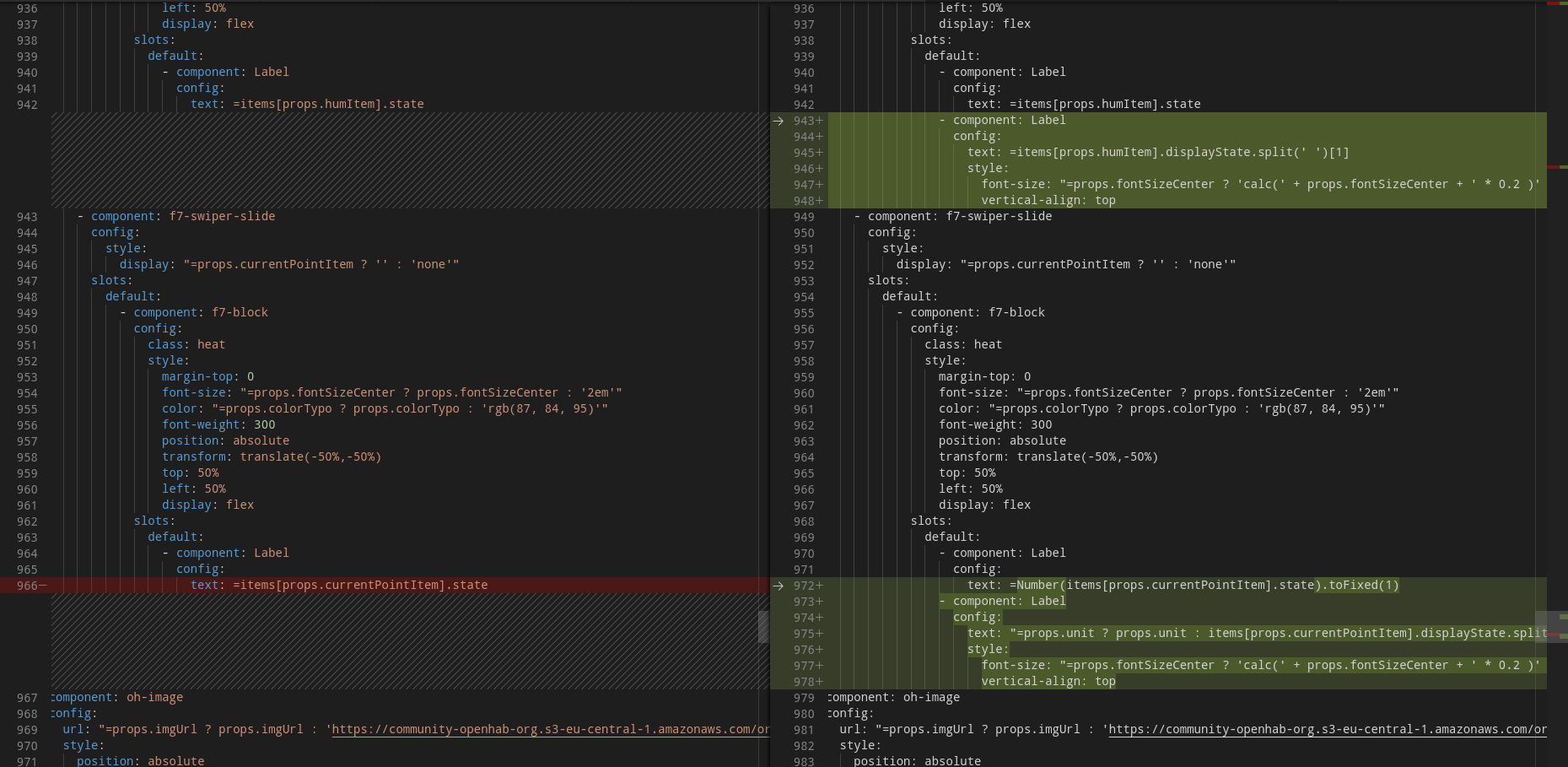

I managed to find the line where I added Number and.toFixed(1). I also found the line where I could decrease the font size.
Really cool widget!
Ah cool you got it!
I also have the same rounding issue, thanks for sharing that :slight_smile: super useful! Maybe I’ll add some comments in the code to help future me…

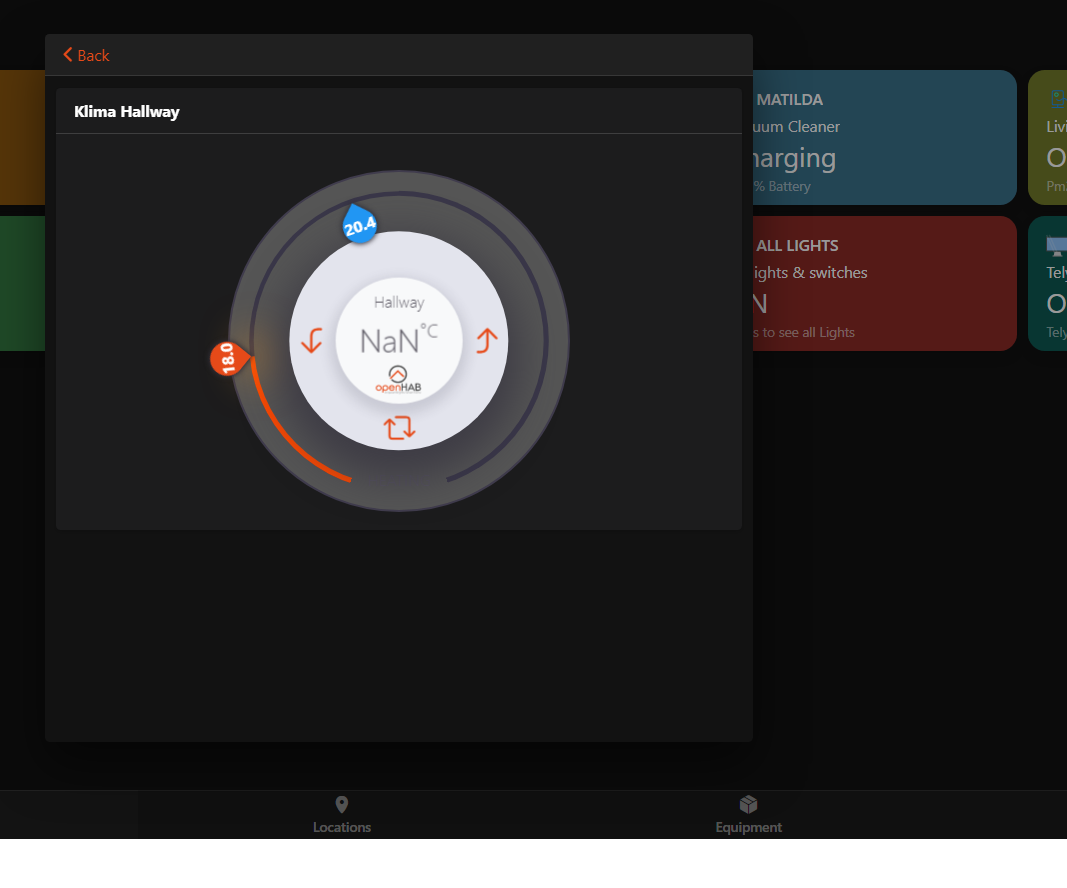

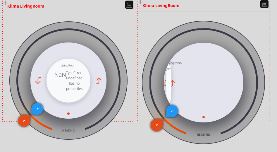

I had a few issues with this widget (v 2.0.0):
  1. Temperature showed NaN
  2. Both temp and humidity showed the following error message: “Type Error: Undefined has to properties”
  3. Graphically the inner circle with the temp and humid readings became a very narrow ellipse rather than circle, making it impossible to see the text.
Here are all the issues in their glory:
I tried some of the suggestions here, and I didn’t get anyone to work, so I made my own.
My solutions:
  1. Simplify row 966 as seen in the diff screen shot
  2. Remove unit text all together as seen in the diff screen shot (since my item already includes the unit)
  3. Make sure to configure the size to 400 px. Otherwise it scales dynamically with your canvas, which seems to screw it up.
I hope this helps someone. Maybe the NaN issue people have reported is the same as mine?
Oh oh… I also have the same issue. Gonna try this :slight_smile: thank you!
I have copied your code and finished your adaptions to OH4 (item units).

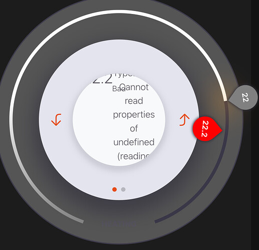

Hi all. First of all thanks a lot for this superb widget!
I have two problems I would like to get your opinion on. First, occasionally, I get widgets that look like this:
The error message says: Type error: cannot read properties of undefined (reading 'split')
What’s going on there? On the ring, both the current temperature and the setpoint are shown correctly.
Second, I get this:
My items are defined with this state description pattern:
stateDescription=""[pattern="%.1f"]
But apparently, that does not help. How can I round this to a single digit after the period?
Any help would be greatly appreciated!

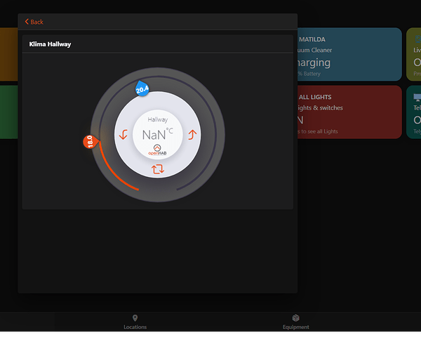

Same problem here (NaN as a temp reading), latest version didn’t solve the priblem.
Running 4.3.0M2
I didn’t check the code you need to scan it yourself but this happens when you display item.state instead of item.displayState.
Thanks, I just tried this but that does not seem to do the trick, unfortunately.
Like Eric, also did not do the trick here. :frowning:
How is your item definded? Please show the complete item config.
