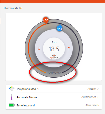

first, thx for reply.
Here is the yaml of the list-card:
component: oh-list-card
config: {}
  default:
    - component: oh-label-item
        item: radiator_valve_01_Mode
        title: Temperatur Modus
        icon: oh:heating2
        iconUseState: true
        action: options
        actionItem: radiator_valve_01_Mode
        item: radiator_valve_01_ModeX
        title: Automatic Modus
        iconUseState: true
        action: options
        actionItem: radiator_valve_01_ModeX
        icon: oh:temperature
        item: radiator_valve_01_Battery
        title: Batteriezustand
        icon: oh:lowbattery1
        iconUseState: true

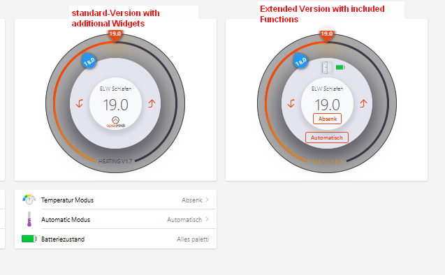

I’m using now Version 1.7 of your Widget, therefore I made a little change in the code to see directly which Version I’m using:
I’m also wondering what would happen with the openHAB-Label, when the Internet-Connection is broken, as I understand that the image comes from an external internet-adress.
Again thx, for this great widget. I was several times asked for this awesome widget in the german community and I hope you don’t mind if I recommend this site to others.
Cheers
Peter
Edit: I forgot to say that it would nice if the information could be shown/changed in the corners of the widget, so no extra place is needed (only a brain-fart :wink:)

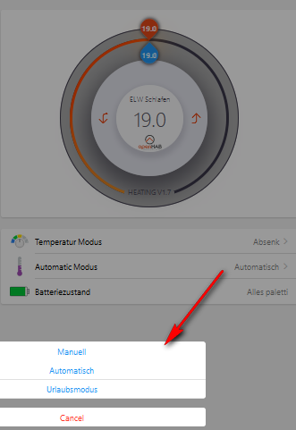

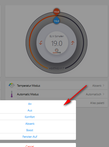

Hi Alex, thx for reply and your hints.
I think your ideawith the window is nice and very practically.
Some side-information:
The battery-low info is more or less from a Switch-Item(Channel is read-only).
The Mode-Items are Type ā€œStringā€ with ā€œSetpointā€ with several options. So the result looks:
and
I think the information comes from the Binding-Channels, so a Switch-Item can’t help in this case.
As I’m not very good in coding and programming, I will wait if Nico find a solution, but I will have a look at your code, maybe I can learn a bit for future purposes.
Cheers,
Peter

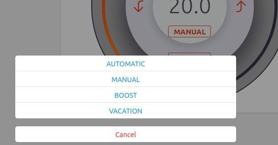

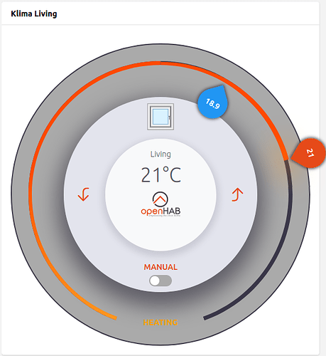

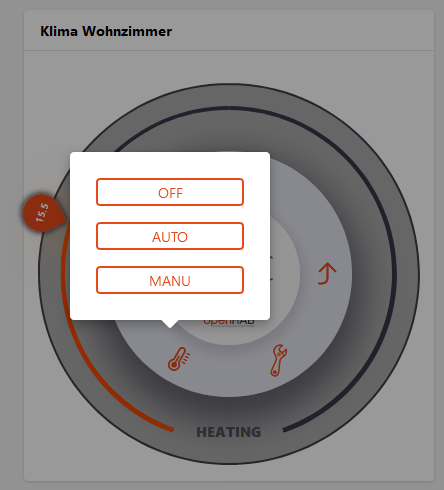

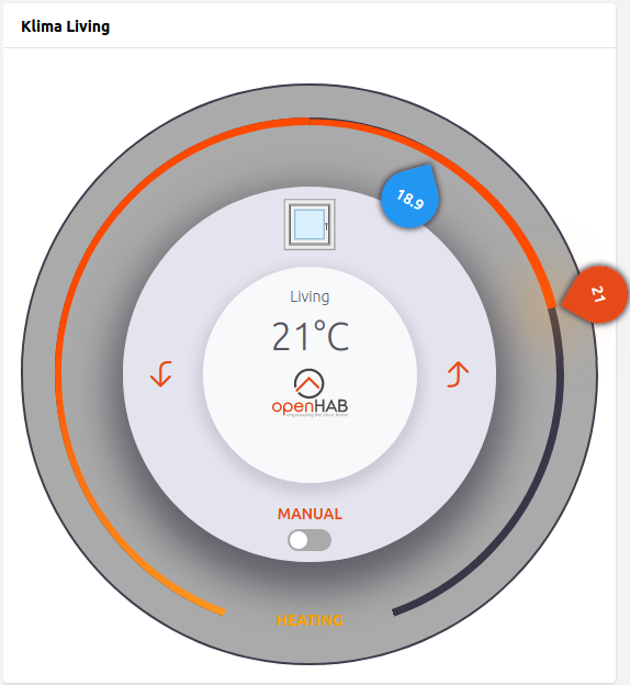

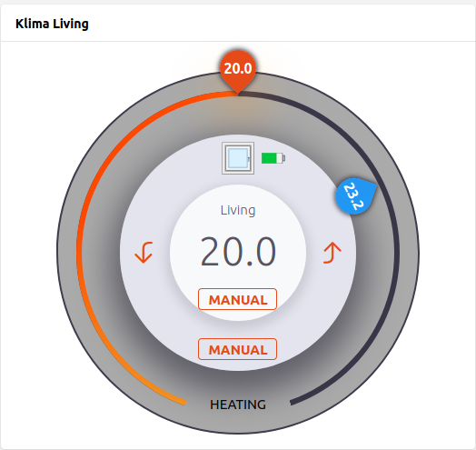

Hello!
I implemented (i hope) what you needed. See screenshots:
Few notes:
removed toggleItem (I think this functionality can be covered with buttons)
modeItem now display popup for setting
added mode2Item, also with popup. Because my thermostat have only one mode switch setting, I use same for both switches in demo (unfortunately, if enabled replacing openhab logo, I unable to find better place for it, blame my lack of designer skills here)
added batteryItem to display battery status. Expects OPEN/CLOSED state, but can be easily adapted for other reporting, I hope.
Below 300 px looks rather ugly, sorry

Hi Alex,
many thx for your ideas and the efforts to realise this. The result looks very good even I made some changes.
In Line 445 I changed:
Line: 445   Battery - it's "LOWBAT" (Switch) -Normal ="OFF" and when low -> "ON" (I use a selvmade Icon) and Name from windowItem to batteryItem
old:                                 icon: "=(items[props.windowItem].state === 'OPEN') ? 'batterylevel-10' : 'batterylevel-70'"
new:                                 icon: "=(items[props.batteryItem].state === 'OFF') ? 'lowbattery1-off' : 'lowbattery1-on'"
and I also tested this code with f7:icons baut it doesen’t work
      I also tried this code, but it seems not to work
new:                                 icon: "=(items[props.batteryItem].state === 'OFF') ? 'f7:battery_100' : 'f7:battery_0'"
                                     iconColor: "=(items[props.batteryItem].state === 'OFF') ? 'green' : 'red'"
To Display the Modes as they are translated by the Binding I changed this lines:
Line:  591
old:                                      text: =items[props.mode2Item].state
new:                                      text: =items[props.mode2Item].displayState
Line:  469
old:                                      text: =items[props.modeItem].state
new:                                      text: =items[props.modeItem].displayState
I also deleted one line as I don’t want to see the location twice:
Line: 126                  I deleted this Line as I can see the Location in the Thermostat itself
old:  title: "=(props.location) ? 'Klima ' + props.location : ''"
new:  Line deleted
And last but not least I changed this line (only for my personal numeration):
Line: 283
old:                                       text: Heating
new:                                       text: Rel.V1.7_na
which means: Base is Release 1.7 from _n (Nico) with the extensions from a (Alex) :wink:
And as a result:

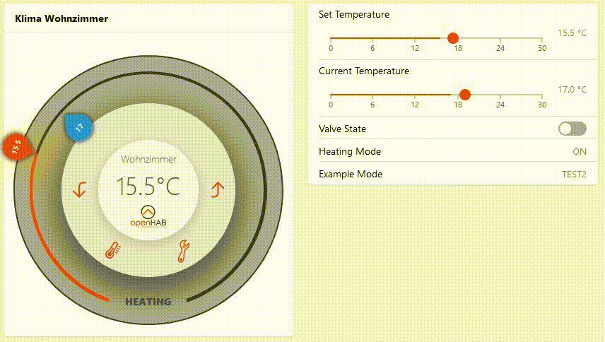

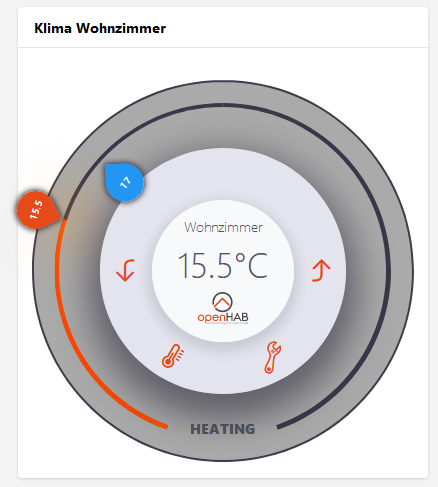

Thanks again for the positive feedback. I am pleased that so many people are interested in the widget.
Hi @fibu-freak,
based on your suggestion (Heating widget - #18 by fibu-freak) with a list-card, i have inserted two optional setting buttons. I think this fits in better with the design and has even more potential. See under the enhancements Heating-Mode- Itemand Example-Mode-Item
I hope you like the solution :slight_smile:
The implementation of humidity will follow.
The Logo-URL can be an Web-Adress or an static-path. I define a prop for the Image-URL. More under enhancements.
Hi @doctor64,
The design should be better now for small widget. You can define the size of the widget and now the size of all fonts.
In general: The implementation of a battery indicator will follow
I hope you all like the new version v1.8. Have fun and have a nice weekend.
all the best,
Nico
v1.8
Enhancements:
  • Implementation of the heating mode and an example mode placeholder.
    The item must be a string item. (props: heatingModeItem and exampleModeItem)
    The strings to be sent are defined in an array e.g. ,OFF, ON, VACATION, AUTO’’ (props: heatingModeArray and exampleModeArray
    The buttons are embedded dynamically after entering the props.
    If only one item is used, only one icon is displayed. If you use two items, both icons rotate into a corresponding position.
  • Toogle item is no longer applicable in the widget. If this is required, it can also be implemented using buttons
  • The url for the logo can be defined in props and is no longer static in the code.
    Tipp: Instead of an Internet address, a logo can also be saved in the folder.
    Then use in the prop the follow path (eg):
    http://local-IP-Adress:8080/static/folder/img.svg
  • All font sizes can be defined using parameters. This means that even small widgets can be implemented responsively.
  • Animation added in the center that can be used to visualize a valve item or an alarm item
    Now the item must be of the type Switch, but it’s easy to switch to an Contact-Item if you want.
Animation
Bug-fixing:
  • Add box-sizing: content-box to the parent container. Now the circle is really a circle too :wink:.
Here the v1.8 YAML. Too many characters for one post :wink:
