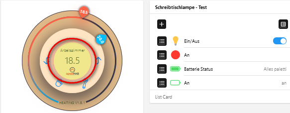

Hi Nico,
fantastic :+1: The additions work all well. Now there are nearly all design-options possible.
The “pulsing Corona” is also a very nice feature, which I tested with a toggling switch of my office-lamp.
The wish of @Sas_Bibic (Translation) could be another interesting feature to make it more comfortable for users of different languages. But I don’t think that this is only done by changing the “state” to “displayState”.
For the moment I’m lucky with your solution and nosy for what is coming next.
cheers,
Peter

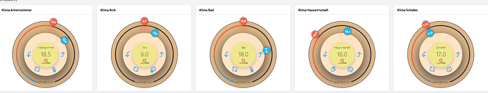

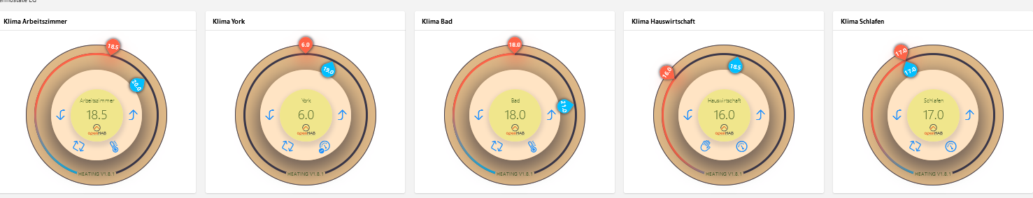

Dear all
Based on this wonderful widget (Thanks Nico)
I try to create widget for personal weather station
Here
Any suggestion are welcome

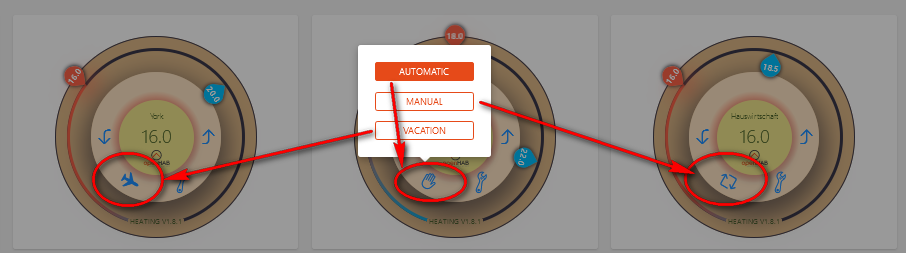

Hi @Nico_R
Thank you again for your work.Popup menu looks really cool, and heating animation beautiful.
Unfortunately, I observe strange behavior of heating mode icon. On page open it displays default value (thermometer), when I switch to different mode icon switched to assigned to mode (airplane, hand, etc) but then i switch to another page and back to page with widget icon become again basic thermometer.
Widget version is 1.8.1
I am glad. In which German forum did you post it? Just out of interest because I’m from Germany too. :wink:
I tried to reproduce the error but didn’t succeed. When I switch between pages the icons stay as defined.
The icons are firmly defined in the code. The states of the string item are defined in the heatingMode array.
The first array key gets the hand_raised icon, the second key gets arrow_2_squarepath icon and the third key gets airplane. If you use more than 3 keys, the key> 3 always gets the thermometer.

Hi @Nico_R!
Sorry for false alarm, it was my fault. I just by old habit use spaces in heatingMode array, enter this:
AUTOMATIC, MANUAL, BOOST, VACATION
But spaces not ignored here, and of course strings “MANUAL” and " MANUAL" not matched, so default icon drawn.
Then I change array to:
AUTOMATIC,MANUAL,BOOST,VACATION
it start working as intended.
I think it will be common problem for people like me, with background in C or similar languages. I put space after comma by reflex! :slight_smile: So i think it will be good to note somewhere what spaces not ignored.
Again, thank you very much for your excellent work!

Hi Alex,
as I understand the Array (heatingModeArray) and the corresponding Icons should be used in a certain order to interact with the “heatingModeIcon”. So my order is now MANUAL,AUTOMATIC,VACATION,…whateveryouwant:
MANUAL = handraised - Icon [0]
AUOMATIC = arrow_2_squarepath - Icon [1]
VACATION = airplane - Icon [2]
whateveryouwant = thermometer
Code-Line - 508 : f7: "=props.heatingModeItem ? (items[props.heatingModeItem].state ==  props.heatingModeArray.split(',')[0] ? 'hand_raised' : items[props.heatingModeItem].state == props.heatingModeArray.split(',')[1] ? 'arrow_2_squarepath' : items[props.heatingModeItem].state == props.heatingModeArray.split(',')[2] ? 'airplane' : 'thermometer') : ''"
As for me the “exampleModeArray” is more comfortable, I made a little change in Line 589:
f7: "=props.exampleModeItem ? (items[props.exampleModeItem].state ==  props.exampleModeArray.split(',')[0] ? 'thermometer' : items[props.exampleModeItem].state == props.exampleModeArray.split(',')[1] ? 'thermometer_sun' : items[props.exampleModeItem].state == props.exampleModeArray.split(',')[2] ? 'rocket'  : items[props.exampleModeItem].state == props.exampleModeArray.split(',')[3] ? 'gauge'  : items[props.exampleModeItem].state == props.exampleModeArray.split(',')[4] ? 'gauge_badge_minus' : 'wrench') : ''"
to get some fancy icons (not only “wrench”) for the “modes” I’m using there:
The Modes are:
…but the “WINDOW_OPEN” is no Option for me (it’s very special in the Binding)
Cheers - Peter
BTW: For the Boost-Mode I used that Icon:
:wink: :joy: :joy:
I will improve this area with the next release :wink:

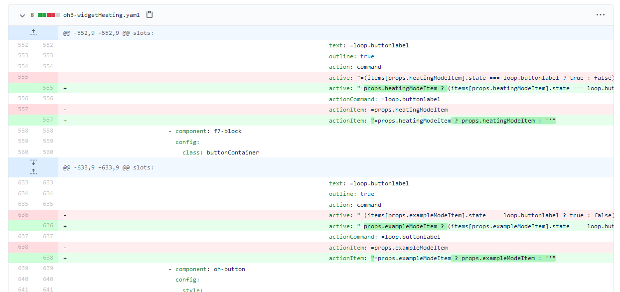

Hi @fibu-freak,
I’ll spend some time trying to figure root of problems. Looks like i found something, but, unfortunately, I don’t know how to fix it.
For example, we have in code for example item
display: "=props.exampleModeItem ? '' : 'none'"
So if exampleModeItemnot defined it will be not shown on interface. But code still have
action: command
active: "=(items[props.exampleModeItem].state === loop.buttonlabel ? true : false)"
actionCommand: =loop.buttonlabel
actionItem: =props.exampleModeItem
I think what OH engine still trying to access item with name in exampleModeItem variable, and because it is undefined generate a warning.

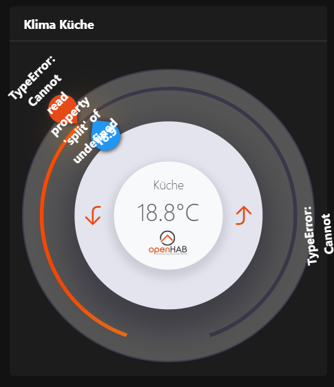

Hi @doctor64 and @fibu-freak ,
That is not completely right. :wink: The error occurs because I refer to an item in expressions which is not defined.
The error is definitely in my code. I’ve tried to ensure it everywhere but quickly forgot in this new lines.
Your guess is completely correct.
I forgot to include the boolean operator in the expressions here.
I have figure the error out and adapt the correct expression in the code.
It must look like:
active: "=props.heatingModeItem ? (items[props.heatingModeItem].state === loop.buttonlabel ? true : false) : ''"
and
actionItem: "=props.heatingModeItem ? props.heatingModeItem : ''"
this for exampleModeItem and heatingModeItem.
The corrected code can be found here without a new tag version.
I hope this solves the bugs and you have fun agian with the widget. :wink:

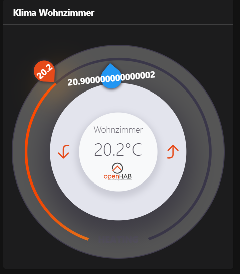

Hello together,

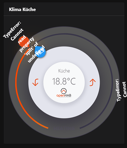

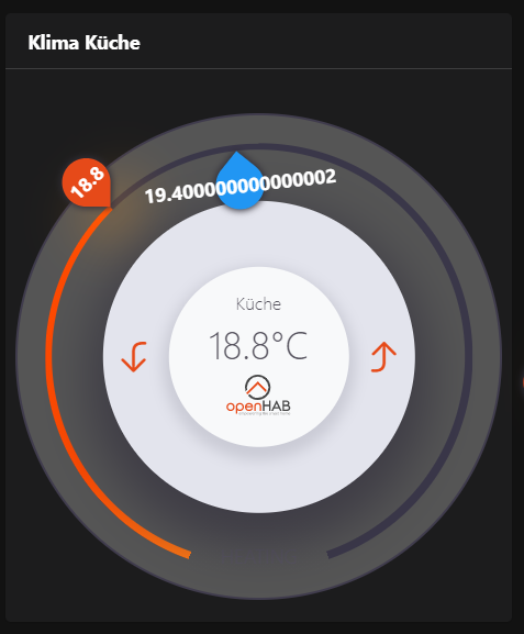

I am facing some issue in the widget with rounding the value of temperature:
The item is defined as shown below:
Number:Temperature    SollTemp_Bad                   "Soll Bad [%.1f °C]"                       <temperature>      (gBadOGThermostat, gTemperature)           ["Setpoint", "Temperature"]       {channel="knx:device:MDT_IP:MDT_HS4:SollTemp_Bad", stateDescription=""[pattern="%.1f °C"]}
Any idea how to fix this issue.
Thanks in advance!
Hi @snowy
Please share your yaml and the two items set and current temperature.
Maybe then i can help.

Hi @snowy
use .displayState instead of .state
Then for example the line 460 in your yaml looks like:
Now:
text: =items[props.setPointItem].state.split(' ')[0]
After:
text: =items[props.setPointItem].displayState.split(' ')[0]
all the best,
Nico
If I change it to displayState i get this Iissue:
Any idea?
