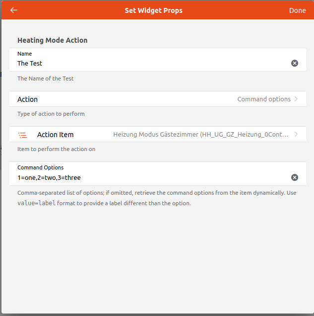

your widget is too complex for me to do it directly, but here is an example how it could work:
uid: TestPK
tags: []
props:
  parameters:
    - description: The Name of the Test
      label: Name
      required: false
      type: TEXT
      groupName: heatingMode
  parameterGroups:
    - name: heatingMode
      context: action
      label: Heating Mode Action
timestamp: Mar 16, 2021, 8:34:03 PM
component: f7-card
  content:
    - component: oh-label-card
        title: ="The current State is " + items[props.heatingMode_actionItem].state
        actionPropsParameterGroup: heatingMode
        item: =(props.heatingMode_actionItem)
        footer: ="For the choice of the Icons you could use, that the first actionOption is " + props.heatingMode_actionOptions.split(',')[0].split('=')[0] + "; the second is " + props.heatingMode_actionOptions.split(',')[1].split('=')[0] + "... and so on"
The props will look like that:
and the widget for this example is:

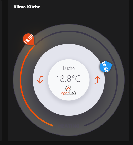

Hi Nico,
thanks for awesome widget, but I have some problems with the latest version (2.0.0), former version work great:
I am using openhab 3.0.2, do you have any idea?
Thanks in advance
Do you have renew the editor preview?
Yes, I did. I solved the NAN and TypeError.
Temperature is received as string with unit (Bosch smart home), therefore I changed the line:
=Number(items[props.currentPointItem].state).toFixed(1)
=Number(items[props.currentPointItem].state.split(’ ').[0]).toFixed(1)
And I needed to insert an unit, then the undefined disappered. Now only the outer ring problem is existing, I did a renew still not visible.
When i add a fixed size, the output is even more strange:
Which Browser?
I will test it, but iam very busy this time.
Hi Nico,
thank you very much for your fast reply, no problem ;). Appears in Firefox (89.0) and Edge as well.

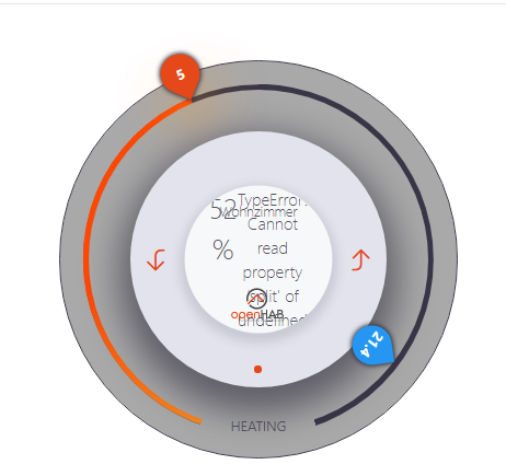

Hello Nico, hello world,
you created a very beautiful widget. Unfortunately I cannot get it to work properly.
It shows NaN°C and _type error Cannot read property ‘split’ of undefined.
Running OH 3.1.0 on an RPI and trying to get Temp/Humidity values of a Homematic IP STH.
What am I missing?
edit: Just played around with my antivirus (sophos) and turned off the web protection - now it at least shows set point and temp onthe outside. the inside is still a mess
