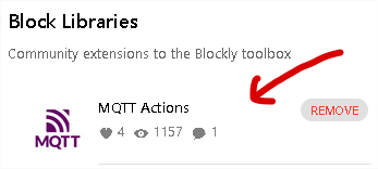

But now I would add Mqtt Action, but I can’t find how indicate it
How I can set it?
OH 3 doesn’t support 1.x Actions. Actions are now a part of the binding and not a separate add-on.
I don’t think this the v1.x Action, it’s the Blockly package that has no instructions.
Although since the OP has a screenshot showing ‘remove’ I would think its already installed.
Yes, I missed that I think.
Yes, indeed, this is the Blocly Library to access the MQTT Actions that are built into the MQTT Action. There is no way that I’m aware of to install anything from the Marketplace using addons.cfg.
But note, again, this is a library that can be used in Blockly rules. It does not provide the actual MQTT Action. It only exposes the Actions that come with the MQTT Binding so they can be used in Blockly written rules (which are graphical rules that only make sense in the UI).

I think there is still some misunderstanding here.
There is not separately installable MQTT Action. You don’t have to install it. You already have it. It’s part of the MQTT Binding.
You don’t need to work around it. You just need to use what you already have. See the MQTT Binding docs for how to get the action in your rule. For Rules DSL it’s something like:
val mqttActions = getActions("mqtt", "id:of:the:broker:thing")
mqttActions.publishMQTT("topic", "message", false)
