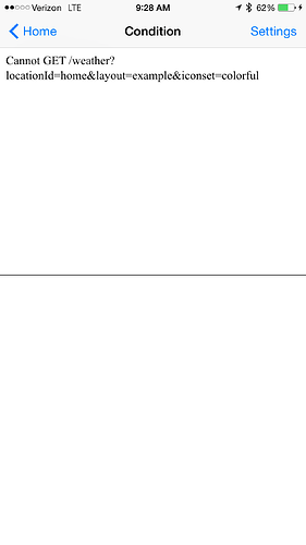

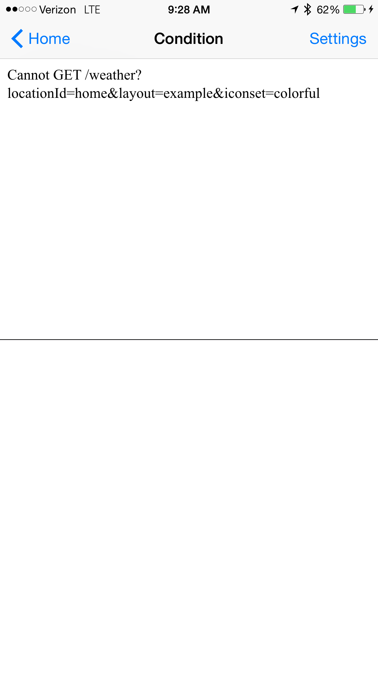

I got everything working on my computer but on the app when I try to access the weather it says it : Cannot GET /Weather?locatioId=home&layout=example&iconset=colorful
I have no issues on my computer it loads just fine but not on my iphone app. It doesnt matter if I am on local wifi or data both result in the error. Everything else in the app works I can change switches on and off and such.
Im very new to Openhab and rather new to coding and any help would be greatly appreciated.

In the UI, I noticed I am not also getting the Outside temperature to populate, or the Max / Min Variables to populate:
Thanks very much for the help! Greatly appreciated!
I wonder if it might be related to the extra bit of text in your item labels, like "Outside Temperature [%.2f °C] °C" should normally be "Outside Temperature [%.2f °C]".
Also, I wonder if your HTML layout would show the proper symbol using &deg; instead of °?
Thanks @watou for the ideas. I tried changing them, but no luck. I switched back to “F” just for testing, but it didn’t seem to make a difference. I get the following in debug, so seems to be working:

Image of most current:
You tried this and no difference? And you also removed the bit at the end of your labels after the ]?
Hi @shep,
I had the same issue and fixed it by using the ASCI code for °C:
<td class="temp-max">${forecast(0):temperature.max(%.0f)}&deg;C</td>
Hope it works for you as well.
Hi @NCO,
Worked great, thank you very much for the help!! Appreciated.
