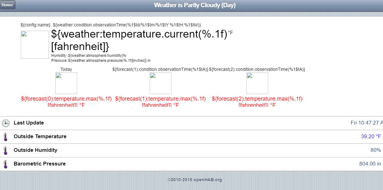

Hi
I have another strange error.
When I use the openhab app and I’m using WLAN in the same network as openhab I’m getting the iconset etc. fine.
When I use 3G/4G (different network) the iconset etc. doesn’t display.
I’m getting follow error: Cannot GET /weather?locationId=home&layout=weather&iconset=flat_colorful.
Someone that getting the same issue?
default.sitemap file:
Webview url=“/weather?locationId=home&layout=weather&iconset=flat_colorful” height=7
Phuong, I’m getting exactly the same issue as you works fine local wifi same error as you mentioned when viewing remotely, did you end up finding a solution?
The “Cannot GET /weather?locationId=home&layout=weather&iconset=flat_colorful” issue appears to be related to the fact that OpenHAB is listening on port 8080. Even though the readme.txt in the layouts folder mentions to call it with /weather?.. if using in a sitemap, it doesn’t work if viewing remotely via my.openhab.org
I guess it must be assuming port 80. If you alter the webview URL to point to http://x.x.x.x:8080/weather?locationid=...etc then it works remotely too. However at the moment it shows just the data remotely ok, it has issues showing the weather image icons - I guess it’s similar issue with the example HTML file, however changing the HTML file to full URL shows large icons on my iPhone rather than small like when viewing locally.

I had basic weather binding working with wunderground, how I want to use yours. When I change my configs I’m getting unknown weather on the sitemap and when I click on weather I get.
HTTP ERROR 500
Problem accessing /weather. Reason: Weather locationId 'home' does not exist
openhab.cfg
weather:location.home.name=home
weather:location.home.latitude=2x.9xx0
weather:location.home.longitude=-8x.3xx6
weather:location.home.provider=Yahoo
weather:location.home.language=en
weather:location.home.updateInterval=10
Yahoo Weather has been going through a lot of changes as of late. They no longer support lat/long like they use to. You need to use a location ID. Review the Weather Binding’s wiki page and it will tell you how to find your location id (I think you just bring up the page for your area and use the last number that is part of the URL.
Thanks for the reminder… I do remember reading this before, I’ve updated my config and added the woeid and now when I restarted I got the scheduling weatherJob-home in my logs.
thanks again.

Running into this. weather works and gets data. the HTML does not… its not replacing the %vars with data? thoughts?
Please post your actual code, not screenshots. It is impossible for others to search to find a solution to their similar problem. It is impossible for those of us who might be able to help to copy and paste the code into tools we might be able to use to help diagnose the problem.
Wrap your code in backticks and it will be properly formatted. You can even use the name of the language and it will add syntax highlighting. In this case:

Will do :slight_smile: Here is the INDEX.HTML i am trying to render and the “view source” output
and the items from the file i am referring to (copied from later posts above )
INDEX.HTML

Note: as of OH 1.7 you can no longer refer to Items from within the webview. You can only access data from the weather binding itself. Therefore your Items are irrelevant to the webview.
With the exception that my file is named example.html instead of index.html I see no significant difference between your and my webview. Is your index.html in <openHAB Home>/webapps/weather-data/layouts?
im running 1.8.2 and my index.html is in the webapps dir… pretty much a copy of the examples.html one… where do I need to run it to get the data accessed?
I have mine in <openhab Home>/webapps/weather-data/layouts as the example on the wiki describes.
