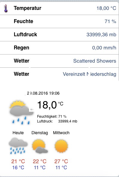

Hi guys,
I recently changed my weather provider from openweathermap to yahoo. I did not make any other changes and nearly all items are still correct. Nearly all…
Oddly enough my pressure item now shows an improper value.
The pressure (“Luftdruck”) should be normally around 1000mb (=hPa). This at least was a common value with openweathermap. But now it is at 33999 mb. Just for information: It’s 1004mb on the yahoo weather website for my location right now.
My item definition is:
Number Luftdruck "Luftdruck [%.2f mb]" { weather="locationId=home, type=atmosphere, property=pressure" }
Any hints?
Thanks,
Stefan
Found out on my own. I had to change the unit to “INCHES” to get the correct mb value. I know, this doesn’t make any sense, but it has worked!
I think this is an error of the binding…
