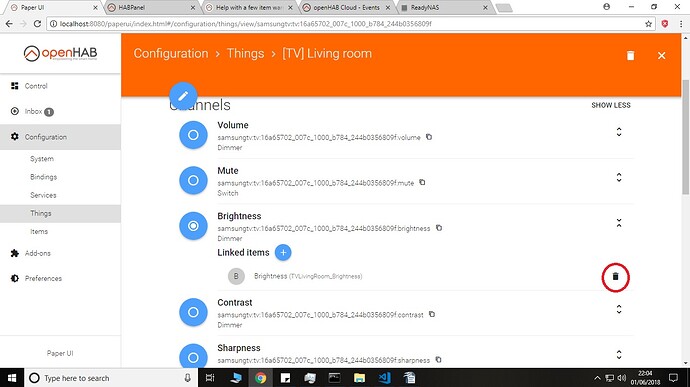

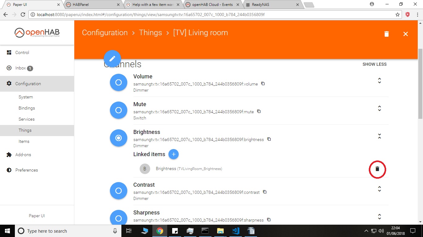

Have you deleted the Items in PaperUI before you try to create them in .items files?
Verify that they are truly gone from your jsondb files. ALL references to the Item must be gone.
In the past I’ve seen Group membership not always updating after editing .items files. It might be something similar is going on here. Try restarting OH after deleting the Items before creating your .items files.
You have to delete the Item, not just unlink it from the Channel. If not deleted then the Item still exists and each Item must have a unique name.

I have been using the trash can in paperUI to delete my items and then save the text file after i thought that was what i was ment too do it
at this point would it be better too keep doing it the way i have been doing it and then delete the entire item jsondb file after ?
i was under the impression that it was recreating the enterys into the jasondb once i saved my text file
the items in question are not part of a group
It seems you were right on the items not being deleted from paper ui i followed the errors and manually deleted the offending items so now im not receiving these errors thanksr that
