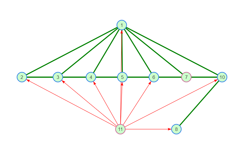

In my setup Node 11 is the Devolo smoke sensor like shown in the graph:
It is linked to all other nodes, does this makes any sense?
