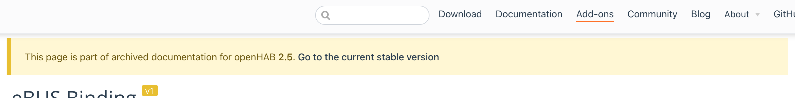

Complete beginner here! I am sucessfully monitoring my Vaillant boiler’s ebus using ebusd an a RPi and now I’d like to try doing the same with openHAB. I have just installed it for the first time on another RPi and installed the ebus binding. However ebus does not appear in openhab> bundle:list.
According to https://v2.openhab.org/addons/bindings/ebus1/ I need to edit services/ebus.cfg but I can’t find that anywhere.

That’s a v1.x style binding and is not supported past OH 2.5.
When running OH 4, make sure you are very careful to use the version of the docs that correspond to the version of OH you are actually running. There is a warning at the top of the docs:

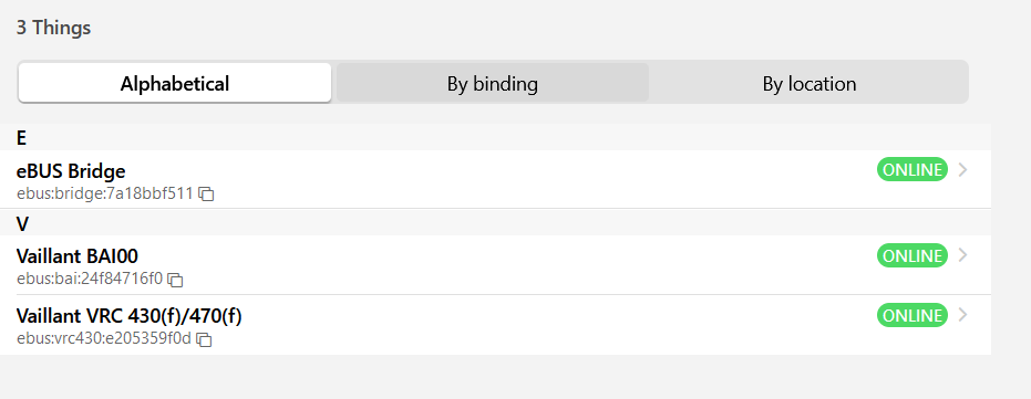

OK I have installed the latest ebus binding and added three Things: my boiler, controller and a bridge.
Now for the really dumb question. What do I need to do to monitor data on the bus? For example, how can I read a parameter called RoomTemp?

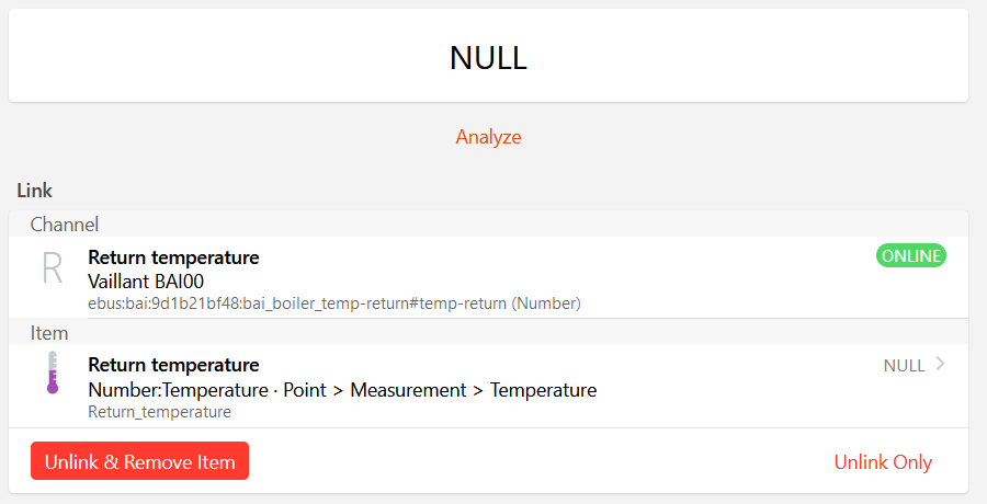

8
OK I’m getting there very slowly.
I have created an item and linked it to a boiler parameter. The Channel is configured to poll every 10 seconds. The Item value is showing NULL. Does that mean that openhab is not communicating with the bus?

could be any number of things. What do the logs say?
