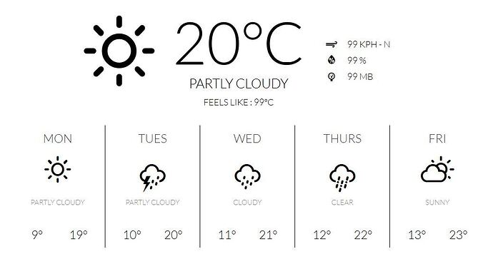

I’ve been teaching myself html/css and a bit of javascript by working up a weather html page that I want to use on/in my OH sitemap but have hit some roadblocks that I was hoping someone could help me with.
My codepen is here: http://codepen.io/PabloNZ/pen/QpBPyb (the array’s for the data were just a way to get it looking right, I know it won’t work quite that way if I have to do GET requests first)
