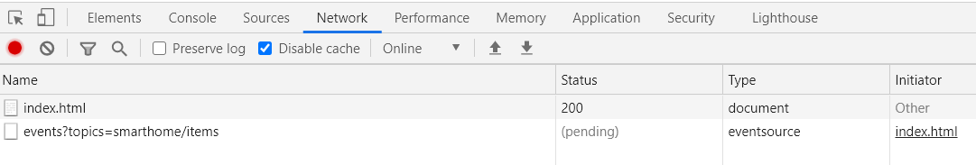

I have test a bit further.
It seems that under Safari the described function is working but NOT under chrome nor Firefox it is not.
From Chrome it is also working as far as I can see.
What maybe is hampering is the authorization ( check if you see in the developers tab a “No ‘Access-Control-Allow-Origin’ header is present on the requested resource. Origin ‘http://zzz’ is therefore not allowed access.” errors)
Putting very basic example in the html folder of openhab2 will give you results in a filtered way (replace with your item)

To get rid of "No ‘Access-Control-Allow-Origin’ you have to edit “service.cfg” under runtime and add the line
“org.eclipse.smarthome.cors:enable=true”.
Then SSE is working on all browsers I have tested.

I am desperate. I have tried everything possible, but I never get a message about my event source.
Do I need to activate anything in openhab? I am running openhabian, on a Raspberry 4, in the latest version.
I do not receive an error message. The HTTP-Request is built and kept open. See picture.
This is the Code.
Does anybody have an idea?
<!DOCTYPE html>
<html lang="en">
<head>
    <meta charset="UTF-8">
    <meta name="viewport" content="width=device-width, initial-scale=1.0">
    <title>EventSource</title>
</head>
<body>
	<div id="result"></div>
    </script>
<script>
if(typeof(EventSource) !== "undefined") {
    var source = new EventSource("http://192.168.178.56:8080/rest/events?topics=smarthome/items");
    source.onmessage = function(event) {
        document.getElementById("result").innerHTML += event.data + "<br>";
		console.log(event);
} else {
    document.getElementById("result").innerHTML = "Sorry, your browser does not support server-sent events...";
</script>
</body>
</html>
