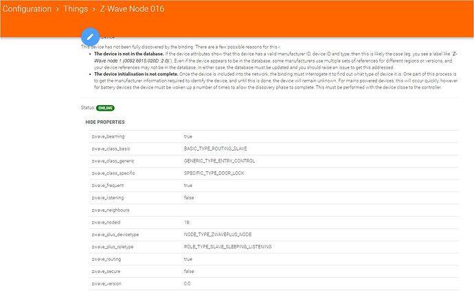

  3. Is this called “the node UI page”? This image is from OH 2.5.12. Node 016 is the 620 lock
    Thank you!

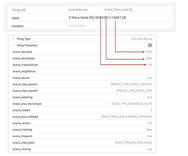

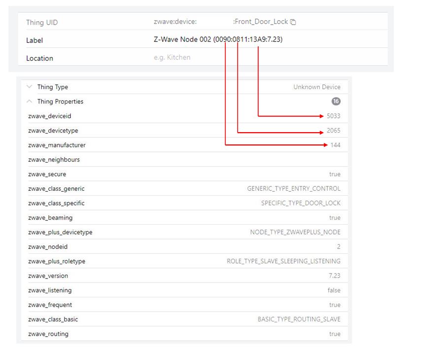

We agree on baby steps. My concern is the device is NOT in the ZW DB. If that is true, everything done so far was a (painful?) learning experience. Devices are recognized by the numbers (in hex), not the model information and I copied the node x message directly from the docs. It is also on your screen shot under the orange bar. Numbers might be covered up by the orange bar. This post is background. I want to confirm the numbers before doing anything else.
One thing to try to get these numbers (since I do not see them in your screenshot). On OH5 with the 10 Pro, put the ZW binding in Debug mode (UI setting page on the right), then put the controller in exclude mode from it’s UI page and press the EXCLUDE sequence from the lock manual. If the log shows that was a success, then go to inbox, zwave, scan while pressing the INCLUDE sequence from the manual. There should be the needed numbers in the debug log

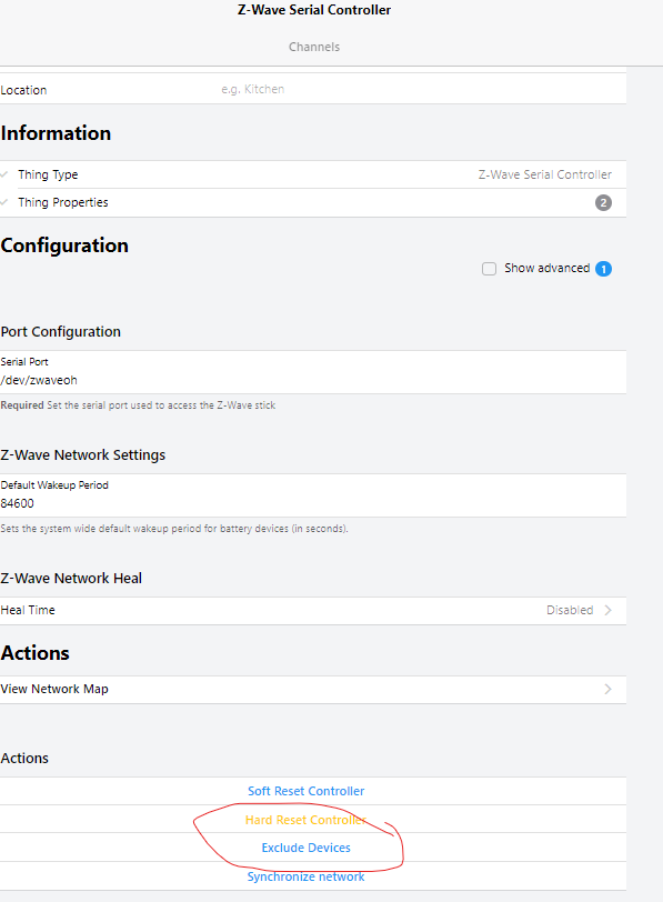

@apella12 Hi Bob, is this the information you need?
Edit to add that there is NO “Exclude Device” in my controller’s Actions
Yes, assume that screen is from OH5 inclusion? There was a bug in 5.1.0 about the exclude, but it looks like the lock is included. The exclude was to make sure it wasn’t still paired with the 2.5. Anyway the device is not in the Db, will need to update. I can get you a file, but maybe not today
@apella12 Yes — that screenshot was from OH 5.1.0.
The lock was paired with OH 2.5 (Aeotec Z-Stick Gen5). I didn’t realize I needed to exclude it; I assumed deleting/removing Thing was sufficient.
Thanks very much for your patience and help.

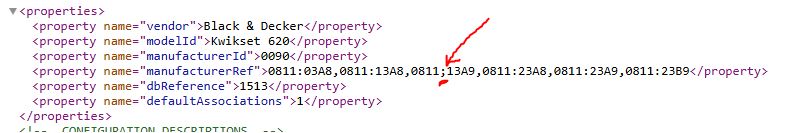

Ok, this has the type:ID from your device. Everything else is unchanged from what is in the DB.
ks620_0_0.xml (6.1 KB)
It will need to be added using the procedure. You may be able to use a compressed file editor, like the last post of the reference.

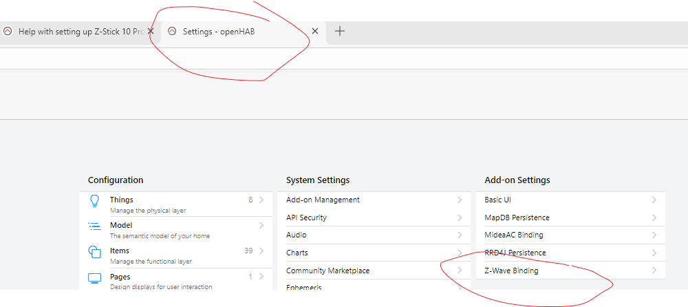

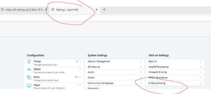

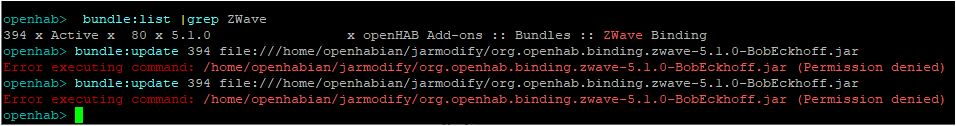

@apella12 Thank you so much for the file. I followed the procedure. Everything went fine except the last step. I ran into a permission denied error
Hope this is an easy fix. So close!
Linux permissions are not my strong suit. I presume that the owner of the jar modify file is openhabian, but openhab itself runs under user openhab.
Rather than guess, the other option that should work is to remove the current ZW binding from the UI (store), and drop the modified jar in addons. You may have to run feature:install openhab-transport-serial in the console. (It is a dependency). Although more complicated, the advantage is that it should survive OH upgrades.

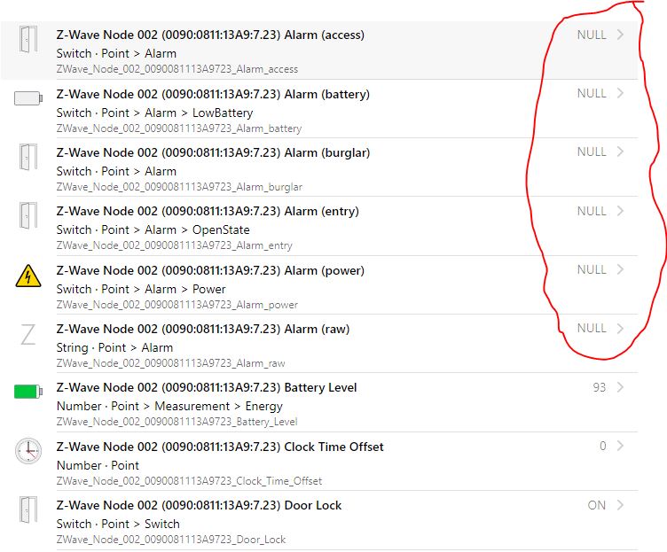

@apella12 Hi Bob, for some reason the Kwikset 620’s Alarm (raw) channel remains NULL. Do you have any idea why? Without the data, I don’t think I can write any rules.

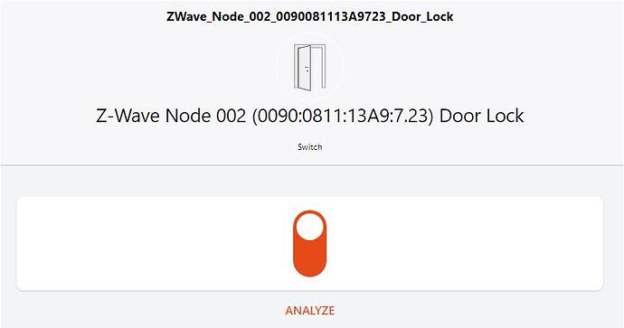

The Door_Lock channel also acts weird in the Items UI:
  1. When I set the switch to OFF, the 620 unlocks, but the switch immediately flips back to ON while the 620 stays unlocked.
  2. To lock it, I set the switch to OFF (it remains OFF), then set it to ON. The 620 locks, but the switch immediately returns to OFF.
I’m not sure what’s happening. I’m considering returning this lock and getting a Schlage BE469, which I’ve had good results with.
I have no locks, so nothing to compare. What I would do is delete the thing, do not exclude, and then scan to pick up again. Everything should be preserved and maybe better.
