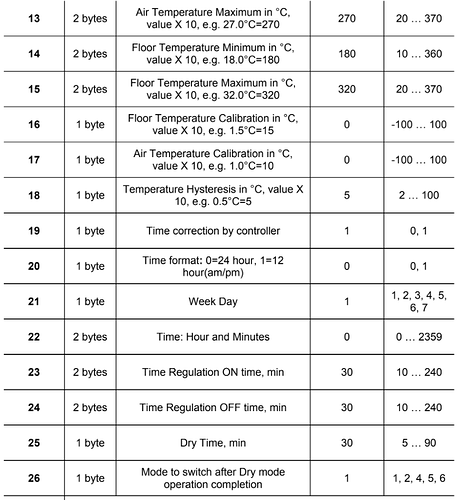

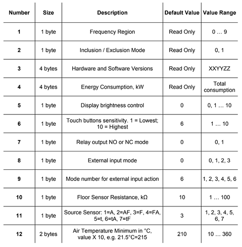

Thanks for answer. By reading both documentation, it seems there is no doubt that we have 2 differents parameters sets for two differents (version of) device
doc of HE-TH01 (the one I have) zwave 700 chips (the new one): https://drive.google.com/file/d/1CgqG39zl5MqTNhfqUAX1d5RbUB95EgPC/view
doc of HE-ZW-THERM-FL2 (the one in Database) zwave 500 series (the old one) :
Hetltun support website where you will found both device :
In documents, you will notice that parameters lists is different:
first parameters of HE-ZW-THERM-FL2 :
first parameters of HE-TH01 :

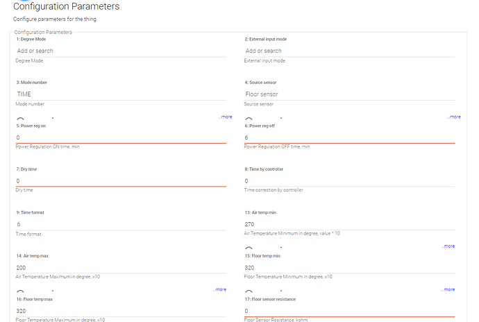

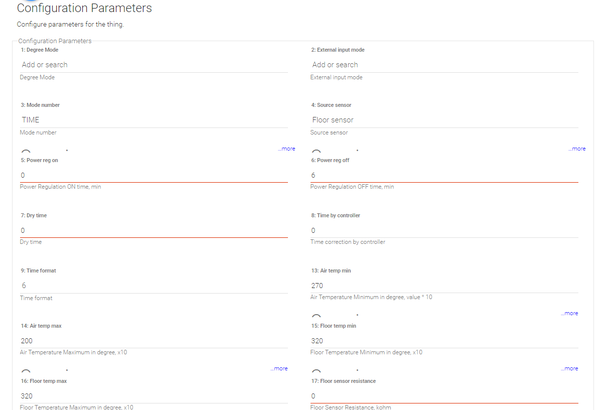

First parameters of my device HE-TH01 reconized as HE-ZW-THERM-FL2 in openhab
So we can reconize value of a HE-TH01 parameters in the skin of HE-ZW-THERM-FL2.
For exemple parameter 15 is Floor temp Max (32°C) and not Floor temp Min as written in openhab.
