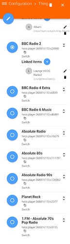

I’ve tried both of the versions referred to in recent comments, but I still can’t link Favourites in PaperUI.
The issue is that the popup doesn’t list options for linking profiles.

When Profile option box is touched, it just shows a blank box, like this

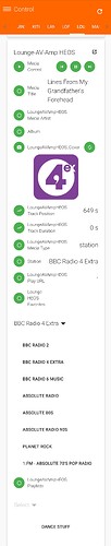

Karaf console shows that I’ve got version No - 2.5.2.202001161839 | openHAB Add-ons :: Bundles :: Heos Binding
Which presents the favourites like this
(I’ve managed to link a Channel using my very first Items file)

I’m not sure what I’ve done differently this time, but putting in this version gives a nice and easy String channel that gets populated with the favourites :slight_smile:
