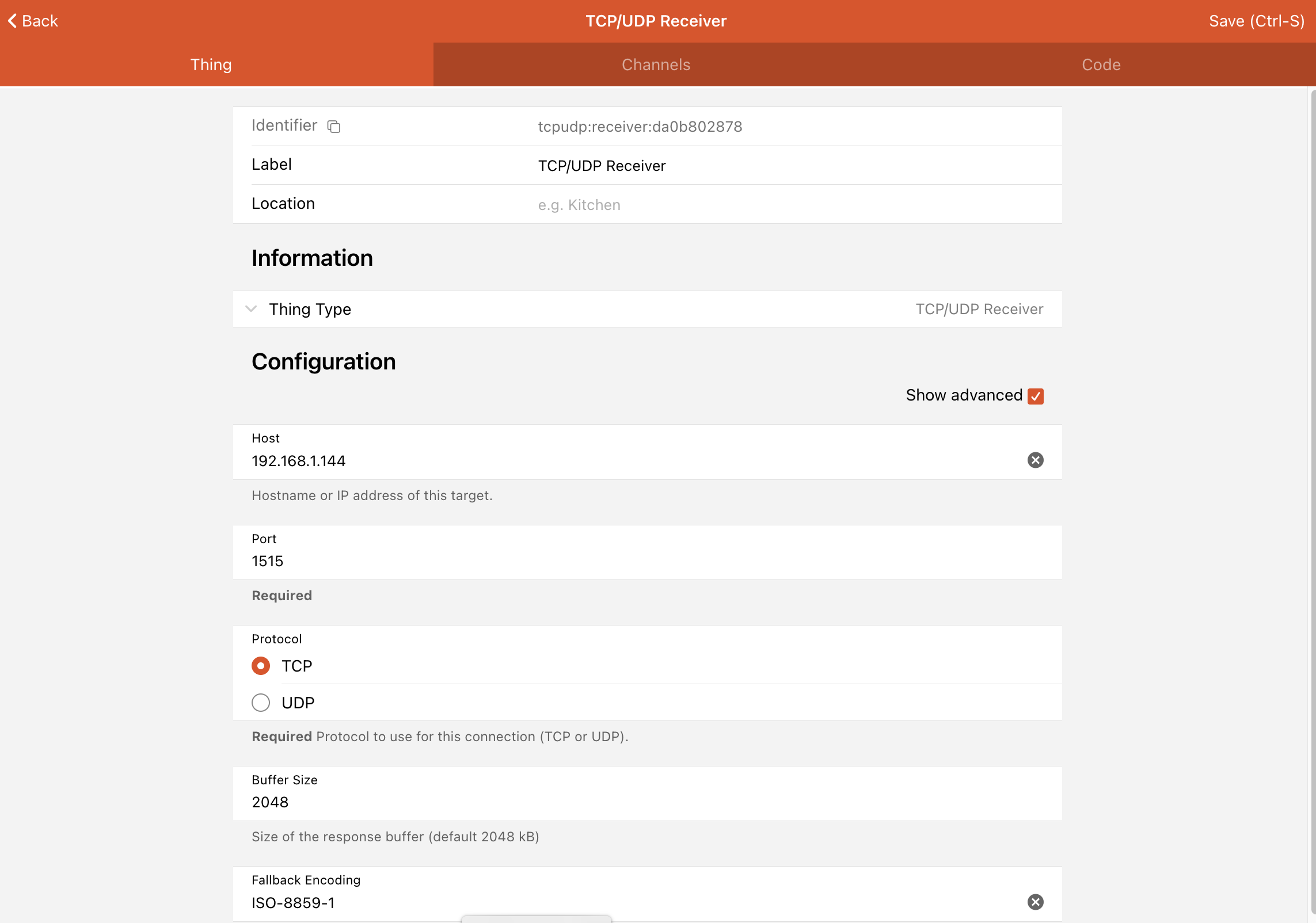

I made the modification in “thing” and indeed it is the correct frame now. However, there remains a problem, I use the “Hercules” utility under Windows to test the control of the monitor and it works very well but with OpenHAB nothing happens even though the good frames sent are indeed linked.
How can I check what the monitor is responding when I am connected with OpenHAH?
I’ve done various tests and checks but I don’t understand what’s going on.
I compared the frames sent by the TCP thing and the frame sent from the “Hercules” utility with a PC and they are identical.
With the “Hercules” utility I have the answer to send (see img_1) how can I see the answer in the TCP thing?
