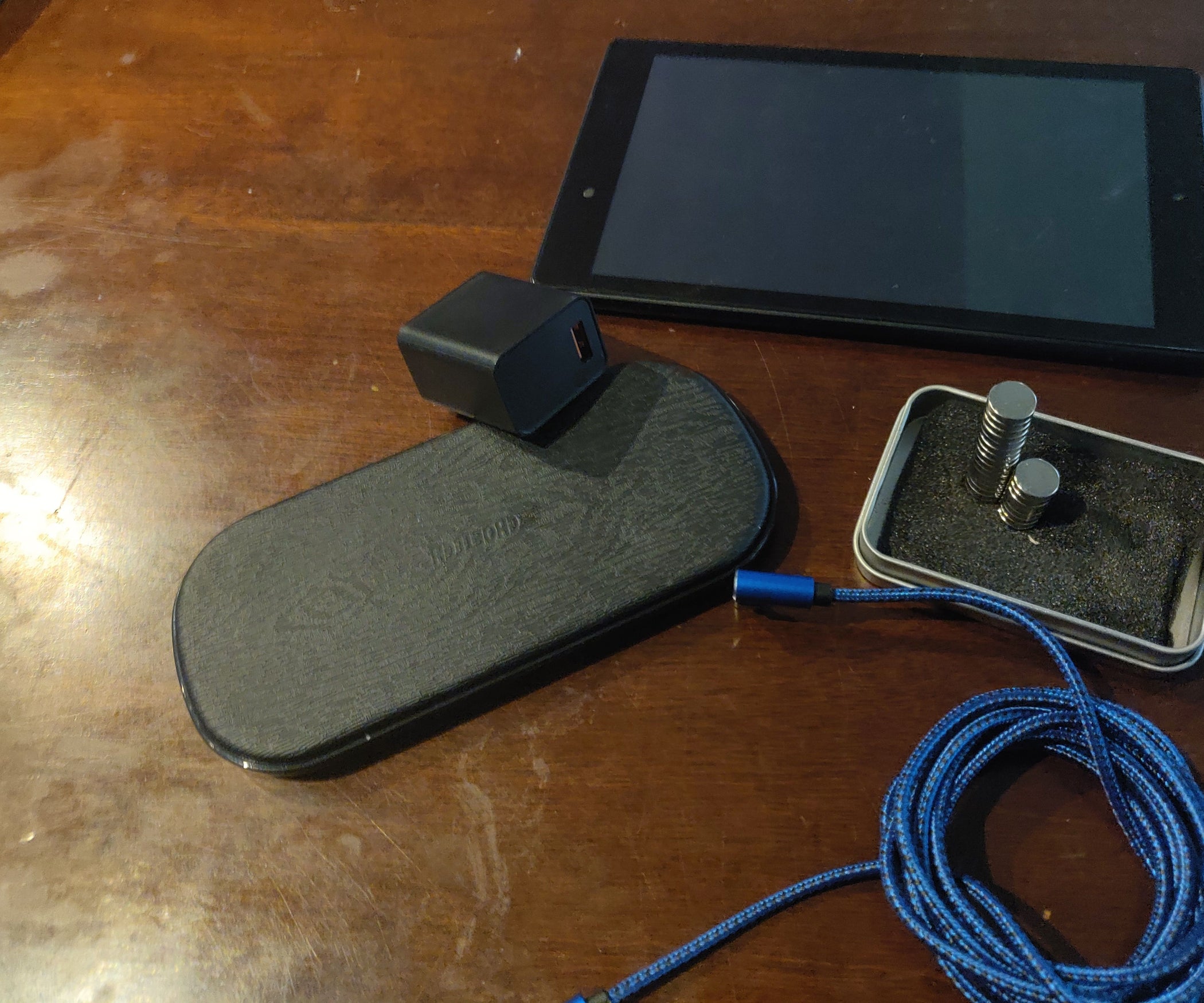

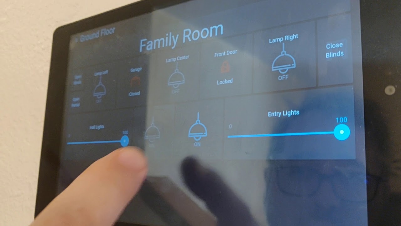

Just finished my project and I think someone here might like it. tell me what you think. In the end, I end up with a wall that looks completely normal but has a hidden spot where you can attach a tablet magnetically and the tablet will keep charged through a wireless charger in the wall. Completely hidden, removable mount. I think it’s really cool and I’d love to hear everyone’s thoughts.

Very doubtful. The charger I had to use was very large and required cutting drywall, patching and painting. I just did it near an existing light switch because i could draw power from it. I noted this in the instructable but i can stress it enough. Getting the position of the tablet relative to the charger is very precise. I found that the charging receiver i put in the back of the tablet had to be in 1 exact spot or it wouldn’t charge. This is why i went with the larger 5 coil charging pad. This charging pad was a lot more lenient in position. it was still tricky to match the spot but the 5 coil pad was easier. I don’t know of any chargers that would fit in a single gang box but if you find one let me know. Just be aware those add-on wireless charging receivers are very position sensitive(if you find or know of a better one please speak up.) Wireless charging was the biggest difficulty and took me a while to really get to work. I have 2 more tablets that i’m going to mount the same way. If i find any more tricks to help I’ll let everyone know.

You are right there is no indication on the wall where it goes. you could definitely place small markers where it should go but i wanted it completely hidden so i just rely on knowing where it goes. Since there are matching magnets in the wall and in the tablet I don’t even have to be exact as it will hone in on the proper location if I’m close enough.
I added links to the magnets i used in the instructable. I hope that helps.
I put the receiver inside the case just so the tablet appears completely normal. I wanted to make this as hidden both on the tablet and on the wall as possible. If you are going to put it in a tablet cover know that you need it as close to the wall as possible since the distance on those receivers and pads needs to be very close.
Using a cover world work just fine as long as you can get the magnets and receiver super close to the wall. If you are using a case you will probably want the magnets in the case and not in the tablet. I don’t know if I put it in the instructable or not but i use a stack of three magnets in the wall to get a stronger hold. If you are going to stack magnets (or use a thicker magnet) know that the strength will increase until the thickness = the diameter of the magnet after that you don’t really get any more strength adding more to the stack. 3 worked really well for me because it was still smaller than the diameter and the stack was small enough that i didn’t drill all the way through the drywall. If you have to go all the way through the drywall to install your stack than you have to worry about them falling out the back of the wall.
