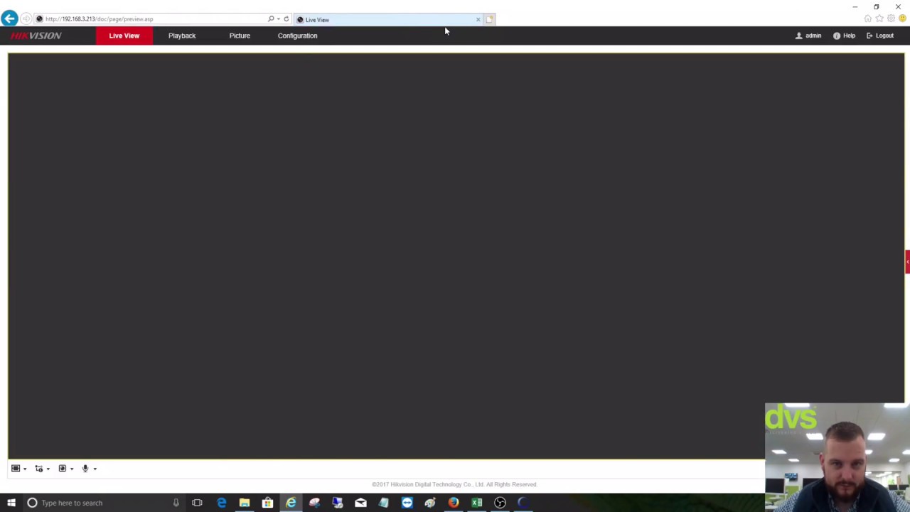

My first thought was that the ONVIF port may not be 80 as the binding uses both ONVIF and also http to talk to the camera, then I found this.
ONVIF is disabled by default in hikvision and this PDF shows how to enable it. Whilst in there take note of any port numbers. I like the fact the hik range can be changed to basic or digest auth as well, my binding should work with either method but I have not heard back from anyone using basic yet as my cameras use digest authorisation.
https://www.hikvision.com/ueditor/net/upload/2017-11-13/c81ae947-b819-4859-b298-fb1ce1f463ac.pdf
Have now enabled ONVIF that was disabled last upgrade.
New error
2018-05-08 10:22:50.559 [INFO ] [ing.ipcamera.handler.IpCameraHandler] - About to connect to IP Camera at IP:192.168.192.85:80
2018-05-08 10:23:22.384 [INFO ] [ing.ipcamera.handler.IpCameraHandler] - About to fetch the Media Profile list from the camera
2018-05-08 10:23:22.446 [ERROR] [l.internal.messaging.saaj.client.p2p] - SAAJ0008: Bad Response; Bad Request
From looking at the error code it seems to be an issue with onvif password, however I suspect it is because the user name and password also need to be setup on HIKVISION to work. There is an excellent video that covers this in the first 3 minutes and is direct to the point (link below). Because it may be possible to have a different user/pass for the API it would be a good idea to make sure the onvif user and password is identical to the HTTP api details as my binding does not allow for different user and passes. Lastly best to use a admin user until it is working to rule out that as another cause of it not connecting. The software the video mentions is good for testing if the camera is setup and if this is my binding or the camera…
