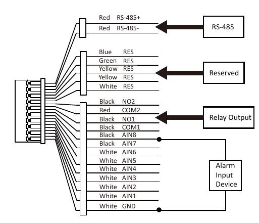

What i now want to accomplish is, that i somehow get the information that someone rang the bell into my openHAB.
  1. There is no binding due to the fact, that HIKVISION is proprietary stuff → NOT POSSIBLE?
  2. Using one of the Pins of the device, to grab a signal and “measure it” via e.g. Shelly i3 from ds-kh6320-wte1 or DS-KV8113-WME1(B)
Has anyone experience with that?
I think all of the “alarm” pins are for the device itsself to start the alarm, but not provide the information, that an alarm is present at the moment …

My devices ship with a PoE Switch and the DoorStation as well as the MainStation completely run just via one ethernet cable
The door opener contact uses two pins on the DoorStation, using the externally provided supply
But i need to get the information as soon as someone presses the “Ring-Soft-Button” of the DoorStation
I was hoping, that one of the acressible Pins can be used for that and i just did not see it until know
