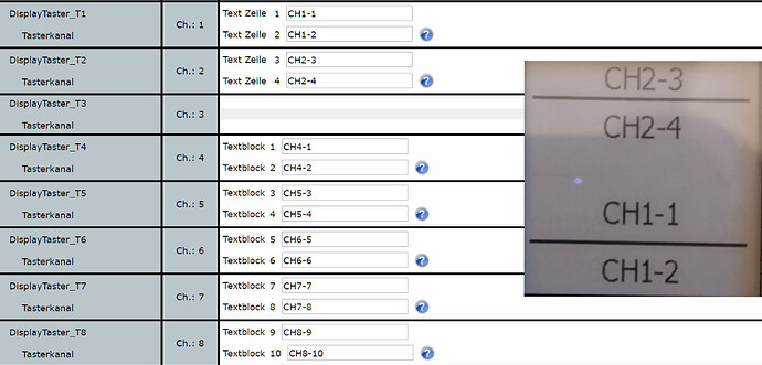

@Thomas_G, @gerrieg I played a bit with my EP device and it is a bit weird. The device has got 5 lines and in the device settings I can set lines 1, 2, 4, 5.
This is a screenshot of the CCU settings and picture of the device after sending these settings:
You can see that there are more lines in the setting then the device supports. It is also not possible to set the middle line via the settings …

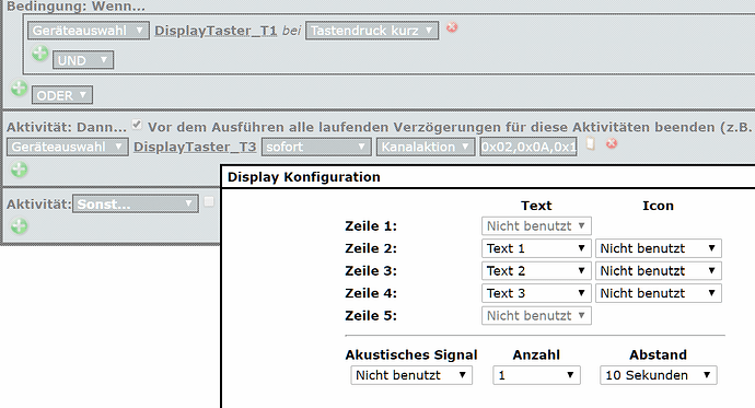

In the next step I wrote a program in the CCU. This looks like this:
As you can see in the screenshot it is only possible to set the 3 lines in the middle by a program. “Zeile 1” and “Zeile 2” are disabled.
This means for the EP device the binding supports exactly the same features as the CCU.
