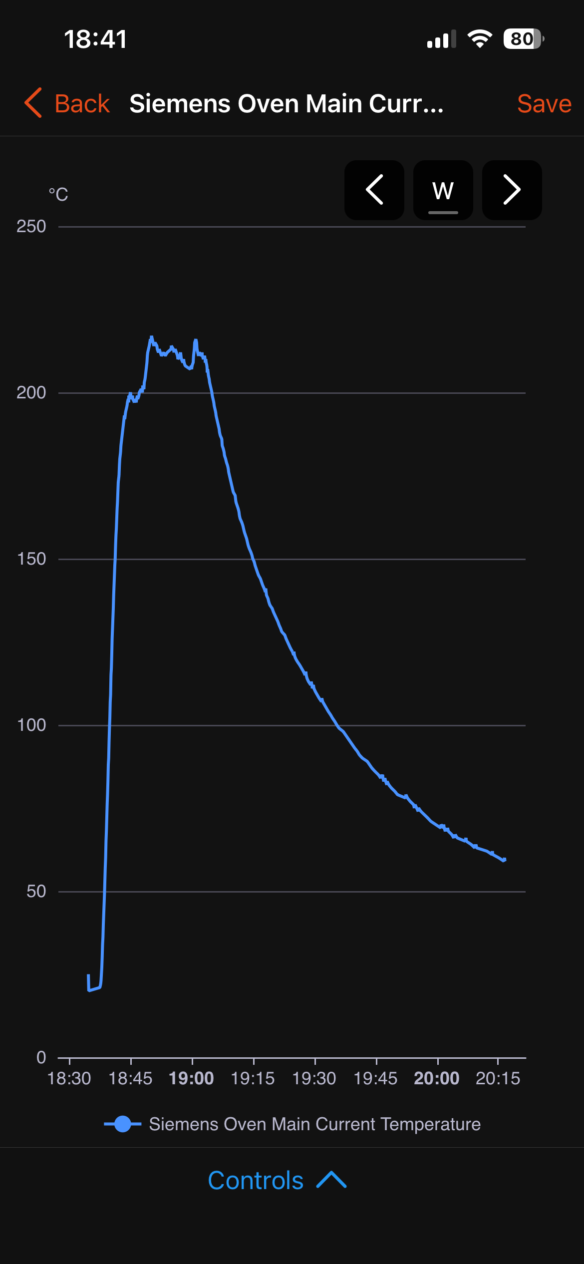

A+! The oven temperature seems to be fixed!!

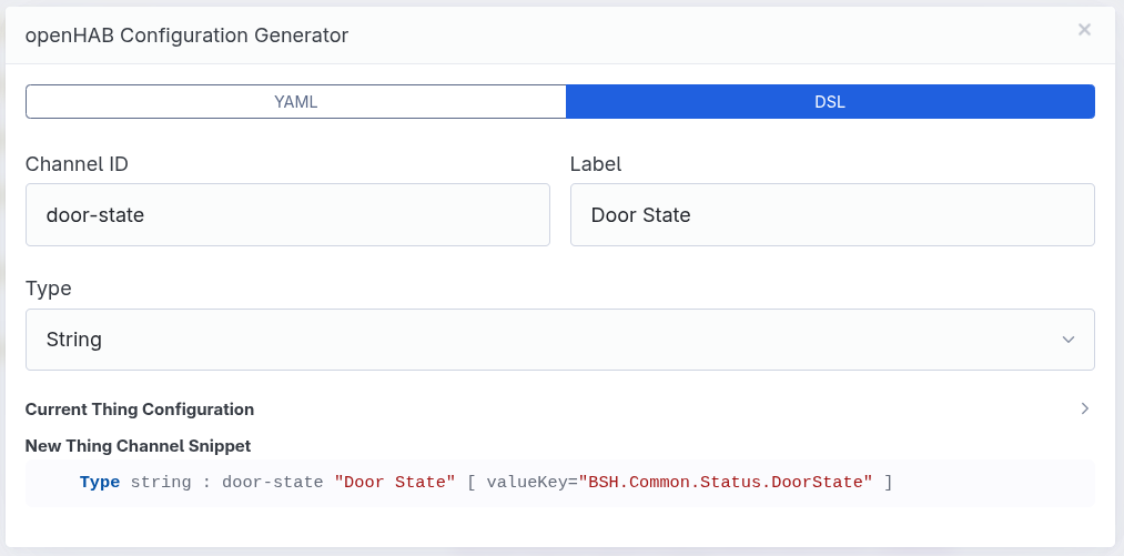

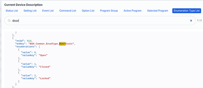

You could try the code generator (see screenshot).
Note: The “Door-State” is a string, not a Boolean value. However, you could transform or map it in openHAB. There are many ways to do this.

I upgraded to the latest version ( 2026-03-11). In general it works fine but I have the same issue like Thomas posted here:
The meat probe temperature is updated regularly but the cavity temperature is updated just once in a while. Any possibility to poll it more frequently?
