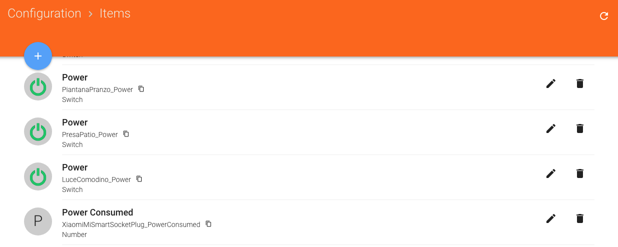

I read that the items have to be present in the /etc/openhab2/things/home.items but in the folder /etc/openhab2/things I have only a Readme.txt file.
Looking at the PaperUI I have items defined as you can see here.
What should I do to have the home.items file filled in?
You can configure your things from PaperUI or use the things.file. It’s one or the other so don’t create in both places.

With OH2, you will use by default PaperUI to setup and configure your Home Automation environment.
Optionally (for more advanced use cases) you can skip PaperUI for the creation of Things and Items and use flat config text files.
Things can be defined in $conf/things/*.things files
Items can be defined in $conf/items/*.items files
(not $conf/things/*.items)
Read more on configuration options here: Configuration | openHAB
