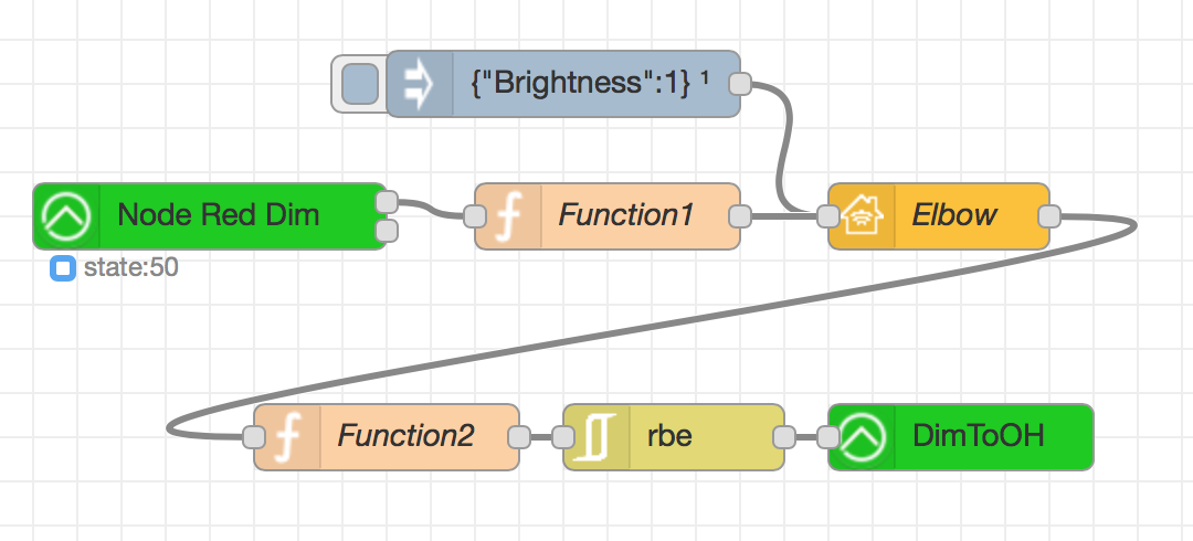

I’m going to follow up here and first say - thank you for posting your function! It was most helpful. I made a few modifications that the community may be interested in - with this setup I’m unable to get the homekit dimmer out of sync with the openHAB dimmer, so long as I never send “on” or “off” and only pass number states through. While this would be an easy addition to the function, I quite like how it works and can easily avoid sending on/off through my dimmers.
My nodered setup is: openHAB->function1->homekit->function2->rbe->openHAB
Function 1:
var results = msg.payload;
if (results < 1) {
    msg.payload = {
        "On": false
} else {
    msg.payload = {
        "Brightness": results,
        "On": true
return msg;
Function 2:
var b = context.get('b')||0;
if(msg.payload.On === false){
    msg.payload = 0;
else {
if(msg.payload.Brightness){
    b = msg.payload.Brightness;
        context.set('b',b)
    msg.payload=b;
if(msg.payload.On === true){
    msg.payload = b;
if(msg.payload.Brightness === 0){
    msg.payload = 0;
if (msg.hap.context !== undefined )
return msg;
The only other addition I have is an inject going into the homekit item set to fire once at startup setting brightness to 1 - this seems necessary for homekit to be aware that the light is dimmable.
And a picture of the flow, for good measure in case someone else has been struggling and searching for this solution. I’m amazed more people aren’t discussing this route for homekit in the forums as it opens up so much for homekit users. Once I found this post and got this dimmer function set up I spent my evening trying out everything from sprinkers to button inputs to smoke detectors - I’m hoping to get everything fully switched over soon.
