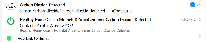

One channel/item for my Netatmo CO2 sensors seems not to work using the Homekit binding: the CO2 level detection contact. Purpose is the application for automations.
Acc. to the specification the contact should change in Homekit @ >1600ppm but nothing happens if the CO2 level is higher. Shown state is continuously CLOSED.
I can’t crosscheck because this channel is neither available within the Netatmo OH binding nor within the Netatmo iOS app.
Just for the avoidance of doubt: Can you confirm that the binding IS creating a channel for this datum? This confirms that the accessory IS providing a Characteristic for this. And that therefore your issue is that the accessory is NOT changing the value of that Characteristic? If so, in order to check if it is a problem in the accessory or the binding, we would need to see the JSON for that accessory both before and after the respective Characteristic should have changed its value.
The channel is provided by the Homekit binding. Will explore the JSON and come back to you.
