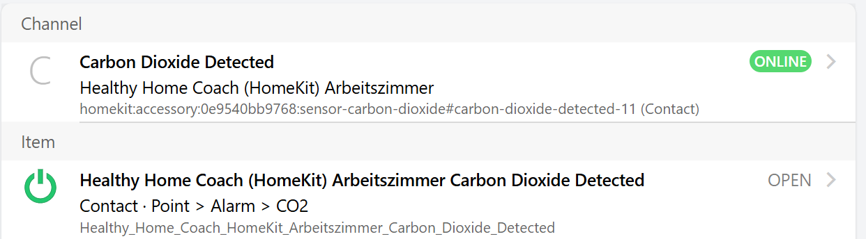

Can confirm that the alarm contact changes from CLOSED at low CO2 levels to OPEN at high CO2 levels (JSON & binding). But i am not able to confirm 1600ppm as threshold level like specified. Need to explore this in more depth, maybe using all my sensors.

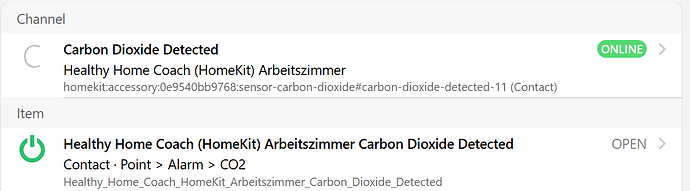

After pushing the contact to OPEN by my breath, i am back again at 1200ppm but the contact is still OPEN.
Probably this feature is not available using the Netatmo binding or the Netatmo iOS app, because it is nothing accurate? :frowning:

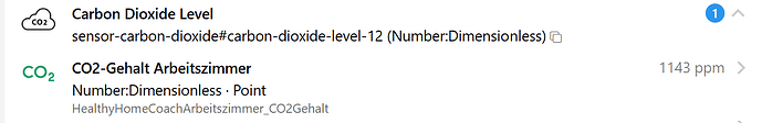

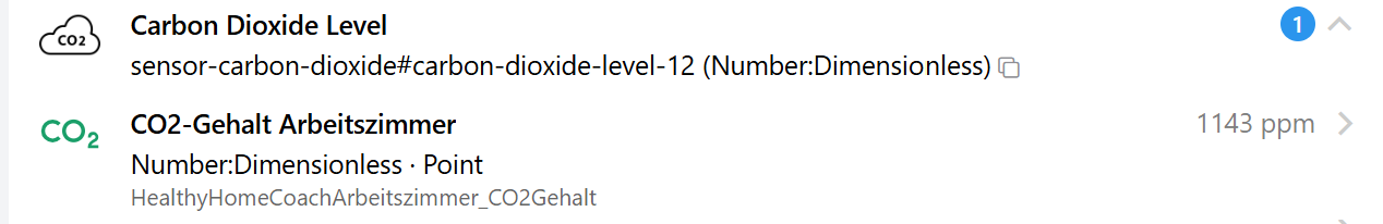

The binding was still OPEN @ 1143ppm and switched to CLOSED at 1100ppm. In my view, this is not okay.

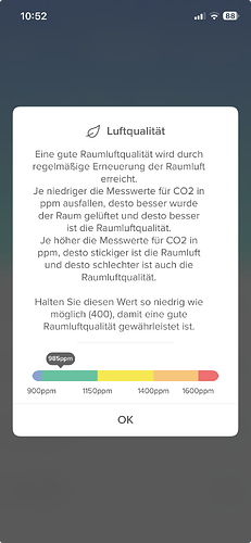

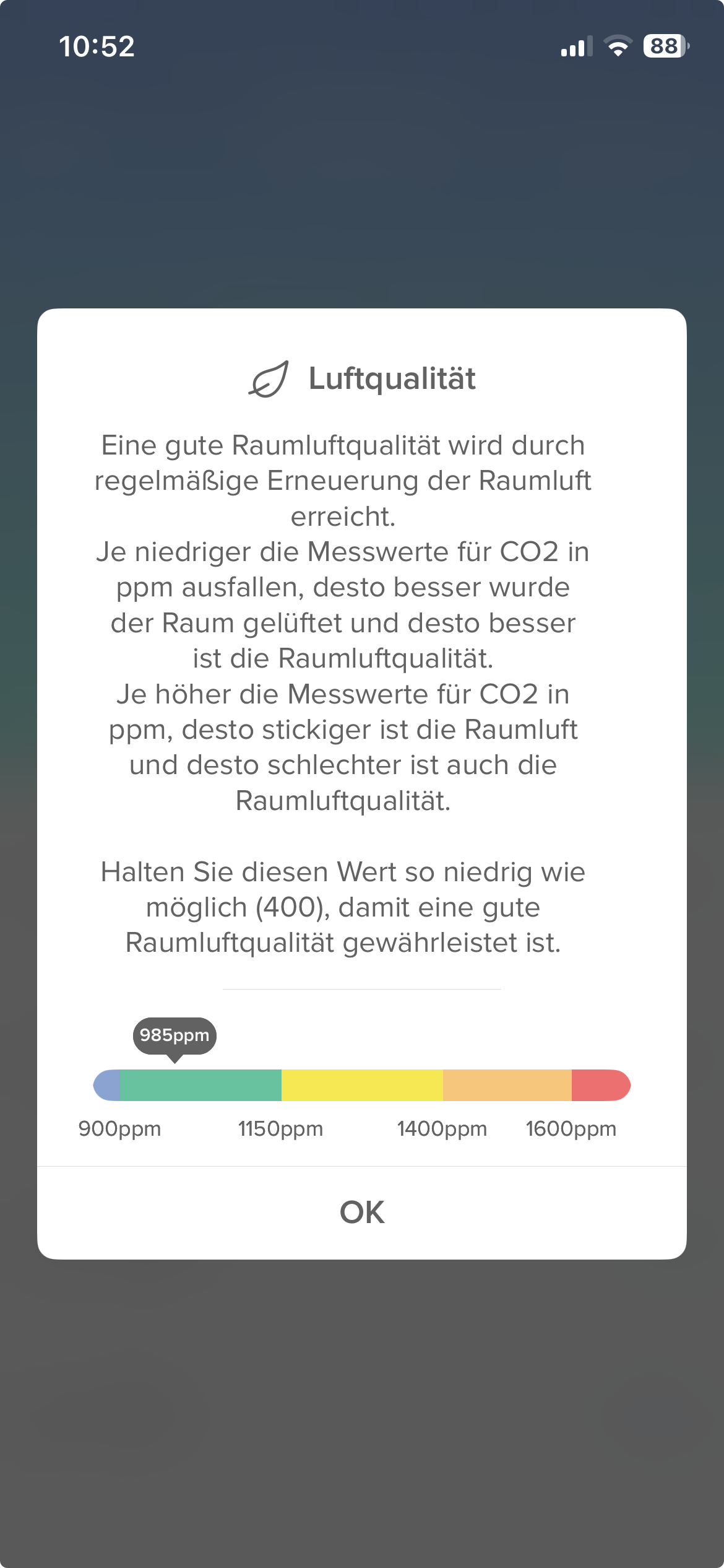

Edit: “Health Index” ranges and threshold levels from the “Healthy Home Coach” app (Netatmo)

Comming from low CO2 levels, the binding was still showing CLOSED (0) @ 1900ppm which should be OPEN (1). Within the spec you provided, i didn’t find a defined level, but 1600ppm matches to the Netatmo threshold from “Poor” (orange) to “Unhealthy” (red) or vice versa.

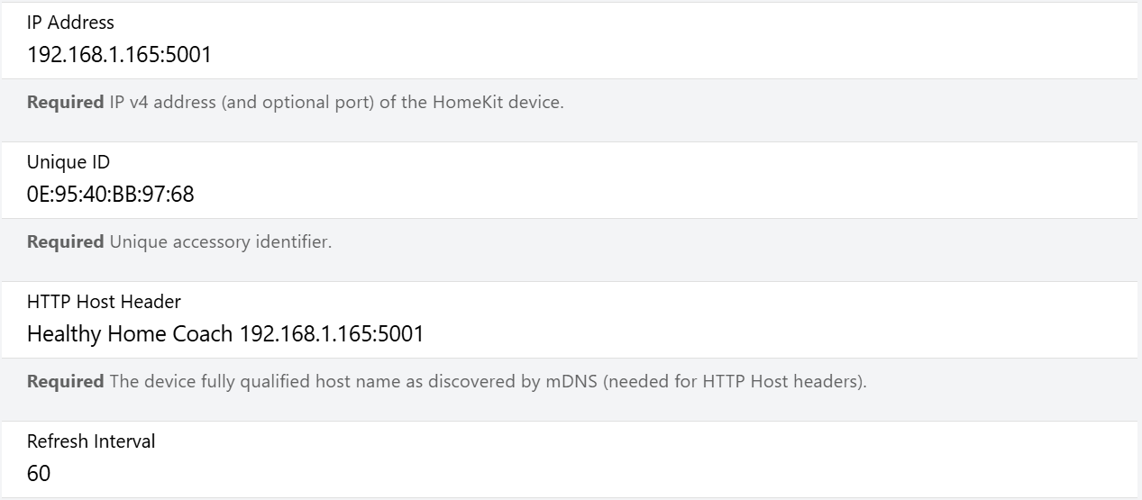

Will take care to get this done. I have 3 sensors of this type. I tried to set the “HTTP Host Header” like this:
Hope that this is better for you?
That is is much much worse! As it says in your screen shot HTTP Host Header must be “The device fully qualified host name as discovered by mDNS (needed for HTTP Host headers”. And if you set anything different than that, then it is very likely that your accessories will either fail to respond at all, or fail with errors. => Normally the HTTP Host Header is set automatically via the Inbox discovery, so since you have now manually messed them up, you will probably have to run an mDNS discovery app in to find the correct texts again.
Just tested 2300ppm but the binding contact/switch doesn’t change while the JSON switched @ 1600ppm.
Conclusion: the contact CLOSED threshold is 1100ppm (tested earlier) and the contact OPEN threshold is above 2300ppm. Its hard to increase CO2 in small steps to evaluate this level more accurate.
I have made a mistake testing the alarm contact provided by the HomeKit binding. The contact item (channel default) should not be mixed up with a switch item. Now i can confirm proper functionality of the alarm contact, even in small steps arround 1600ppm. The threshold value is 1600ppm.

For other OH users who might work with Netatmo binding and HomeKit binding in parallel, there is one information w.r.t. the “Health Index”. Health index scale and CO2 ranges in ppm are different between Netatmo and Apple HomeKit. Thanks to @AndrewFG for providing me the Apple specification.
Netatmo binding and iOS app: 0=Healthy, 1=Fine, 2=Fair, 3=Poor, 4=Unhealthy (5 steps)
