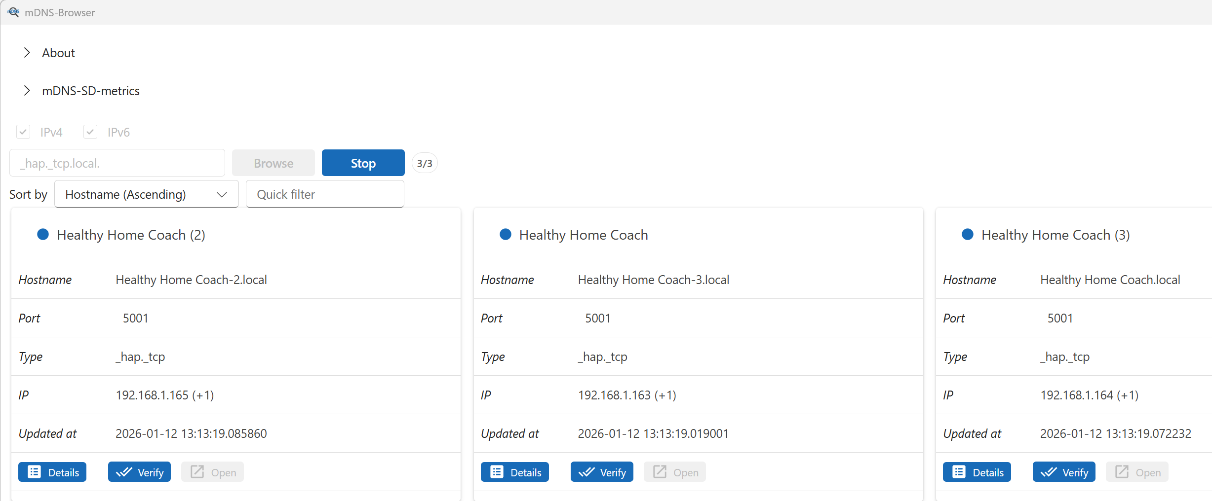

Many accessories expect to receive the exact same Host: header string in the binding’s HTTP requests as they themselves have previously published in their own mDNS advertisement. But it seems that OH and other mDNS apps are applying extra sequence numbers (in various formats) to disambiguate duplicates. These extra sequence numbers risk to make duplicate devices not work. But you are lucky that your devices apparently do not enforce that rule. However I need to dig into this further to figure out a universal solution.
I have again created work for you :wink: . Here is the output of the mDNS-browser from GitHub:

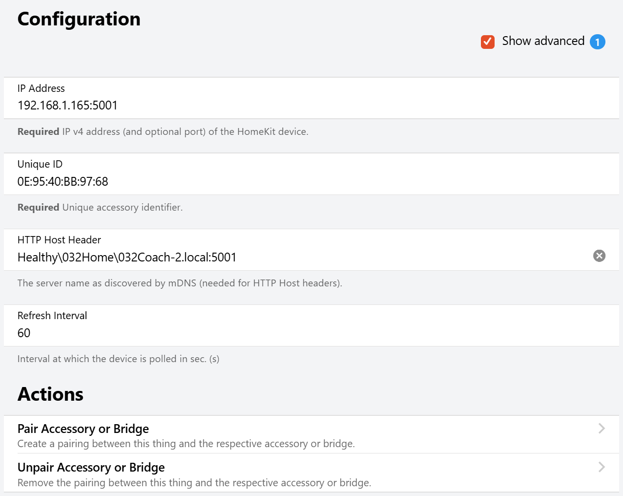

Updated now to OH 5.2.0-SNAPSHOT #5106. Now the Host header adress looks like this:
Healthy\032Home\032Coach-2.local:5001
Did you make this happen?
Yes. Do you confirm that it is still working?

@AndrewFG, one more observation: within the configuration screen, there is a small blue “1” which indicates “Non-default advanced parameter”. Either didn’t recognize this earlier or it is new?
See Refactor config sheet advanced toggle by mherwege · Pull Request #3503 · openhab/openhab-webui · GitHub
Many thanks, understand the purpose of this “hint” now.
