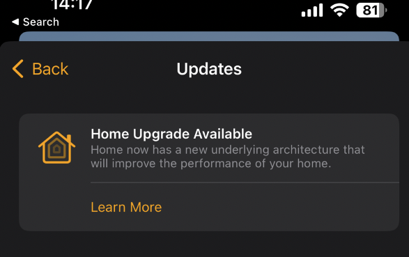

You can upgrade to iOS 16.2, just don’t “upgrade the home” in Home app, which is a manual step AFAICT (mine still warns me about upgrading because my wife’s phone and watch are still on 16.1).
I have the Home Upgrade Available notification - will avoid for now until safe to do so!

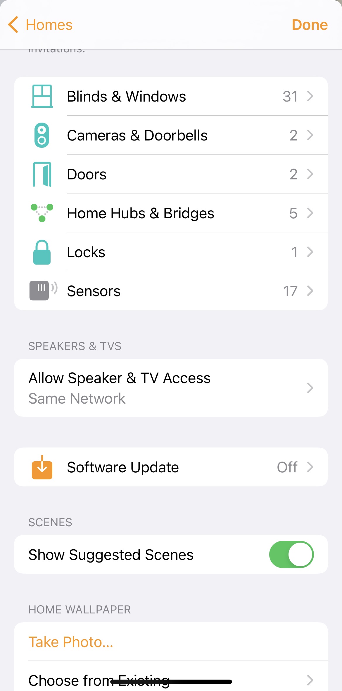

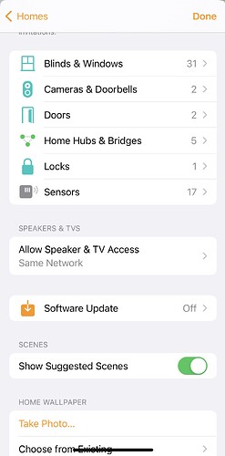

i did an update yesterday to 16.2 everythink works as expected, but i don’t see this dedicated upgrade message in iOS app at all. not sure what to think about it
Jacek, thank you for the confirmation.
in my case, upgrade is hidden in home settings in “Software update”. please check there.

interesting i don’t have this “Software update On/OFF” switch in my ios 16.2 / iphone 13
