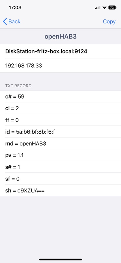

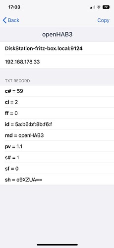

This is what the Discovery App finds:
I have installed a ping app on my iPhone. I’ve tried to ping “DiskStation-fritz-box.local”. But that was not possible. The iPhone is in the 5 GHz WLAN. My Desktop PC is connected over Ethernet. My PC is able to ping “DiskStation-fritz-box.local”.
The Docker Container is running in the host network. So no NAT…
Maybe that is the problem?
Christoph
ok. it is good that you see openhab. so, mDNS is working.

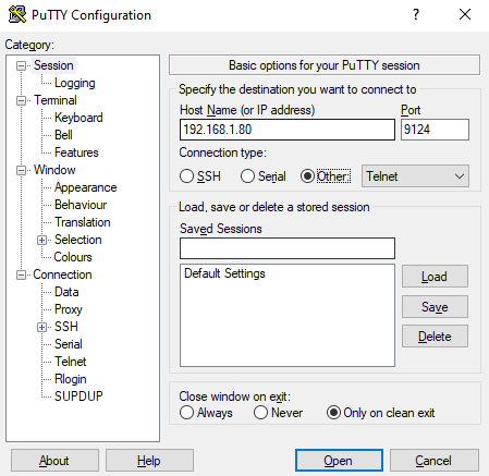

    try to connect with putty, telnet or something to it, maybe there even an app to test a connection on specific port.
    e.g. here is the putty test on my PC
you dont get any response but it should connect
important - ping does not tell much. it is often blocked.
