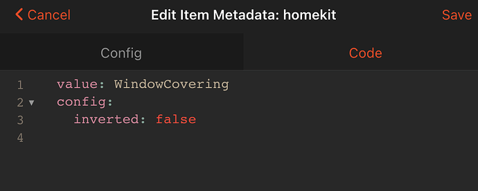

is this valid for openHAB 3.0.1? I tried it but dont work (I dont use files, I do everything with the UI)
can I write it in the “code” tab in the UI? It seems that the syntax is different
yes, the parameter is still valid in OH3. you can add it via UI → code tab like this
value: WindowCovering
  inverted: false
here as screenshot

and this is the Homekit Metadata code for this item:
  inverted: true
