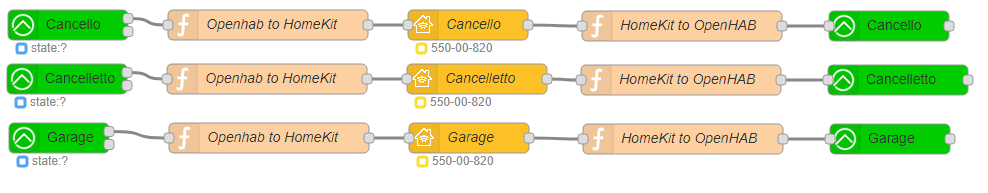

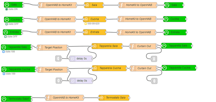

I do not know if you know him, I’ve just started.
I’m making changes to the flow for integrated node-red with Openhab to manage Home apps (Lights, Blinds, Door, etc …)
I did a lot of testing and a lot of time with Openhab’s Homekit binding, too many problems and lack of accessories.
Above all there is no news on future updates, it seems a dead binding, I hope to be wrong..

Meanwhile i’m very impressed of node-red to integrate missing HomeKit “Things/Tpypes” in openHAB :smiley:

@crxporter
I started from your tutorial, thank you very much, I had a new world!
