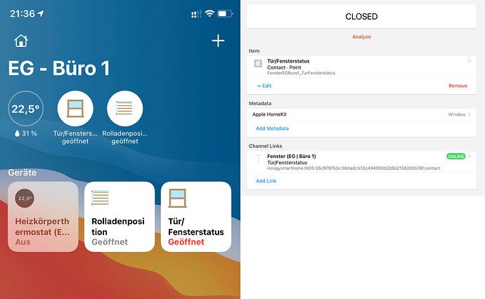

The status of my windows and my doors is reversed in Apple Homekit. When the windows are open, they are shown as closed, and when the windows are closed, they are shown as open in Homekit. So the status is reversed. In Openhab, the state is displayed correctly. How can this problem be solved?
I use Openhab 3.0.1 with the binding from Livisi (innogy)

@yfre @dirkdirk Since I did not get any further with the Homekit update, I have now installed Milestone version 3.1.0.M3. All services are now running again, including the latest Homekit integration. But now back to my problem. Unfortunately, the inverted function does not work. When the window is closed, “open” is still displayed, and when the window is open, “closed” is displayed in Homekit.
This is deposited with “Code”:
value: Window
inverted: “true”
inverted: true is default setting for windows and doors, try with inverted: “false”

Another question. When I open the window now, it is correctly displayed as open in Homekit. However, it still says an opening rate of 1%. But there is actually only one open and closed status for me. How can I remove the percentage?
Door and Window in homekit are motorized doors and windows, which have current and target open state in percentage. you can add current / target position and set them to 0% or 100% depending on status (open/close). e.g. using rules.
but if you dont need percentage then use “ContactSensor” instead of Windows/Door. for ContactSensor you can select in home app the icon, which can icon for windows or for door.
@yfre Perfect. With the contact sensor, it’s exactly what I wanted. Thank you very much :slight_smile:
