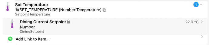

  3. Screenshot the state of the “Setpoint” variable at 12:11pm:
  4. Change the temperature manually on the device MEQ1354719. Change it to 22 degrees
  5. At 12:14:34 in the log, you can see the setpoint update to 22 degrees in the log for MEQ1354719
  6. At 12:15:20 screenshot, the value is not updated in the linked setpoint field:
  7. Stop and start the bridge using the UI circa 12:1548
  8. 12:16:10 the UI is updated (post bridge restart)

  3. Screenshot 12:19:30 - no update yet:
  4. 12:19:50 Stop and start the thing manually (visible in log)
  5. Screenshot - data now updated

I presume this config is working for two reasons:
  1. When I restart the thing the data flows through to the item (so it must be connected)
  2. In the main UI, it shows the thing as being correctly connected:

Are you absolutely sure about the channel UID? Did you copy that from the UI or did you create the Items via VSCode by using auto create feature from openHAB plugin?
Please be aware that the Item type (at least for tempoerature) should be Number:temperature, not Number
Thanks Udo.
I copied from the UI, it works when I stop/start the thing, and it shows in the UI as being linked. I think it is correctly linked for those reasons.
What difference would it give if I define as Number:temperature? The other fields (such as the valve state) also have the same problem, so I presume this isn’t the problem, but I could be wrong.

I can remember that there was a problem if it is not defined as Number:temperature. Therefore it is generally better to set it.

On the number:temperature, I’ll make that change. I’ve had this installation since openhab 1, and that isn’t a change that I’d had to make when I moved to OH2 or to OH3, and it definitely worked for a while. But no harm in changing it. Are there any of the other data types that may be problematic? Is there a place I can get a list of them…or do I perhaps just have to match exactly the data type that the UI reports for each field?
I can see that the two temperatures (setpoint and actual) are defined as Number:Temperature. The valve state is a dimensionless number - I’m assuming I don’t need to specify it as Dimensionless in the config?
OK, I’ve spent the time to rework everything to use Number:Temperature, and therefore all rules to use QuantityType for working variables, and then some of the tricks and tips from this thread: Working with Number:Temperature Items in rules. This was all substantially harder than I imagined, so posting the link and detail for others who may find this thread and need to do the same thing.
