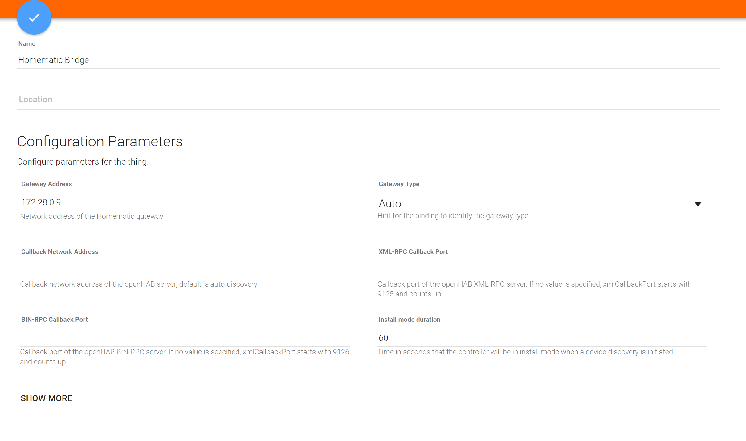

Thing config:
There are some security related changes in this particular firmware (that are unfortunately not documented by eq-3) but in another forum there is some information available (german) that may shed some lights on your problems. → 1 ← and → 2 ←
OK, but what can i do that it works?

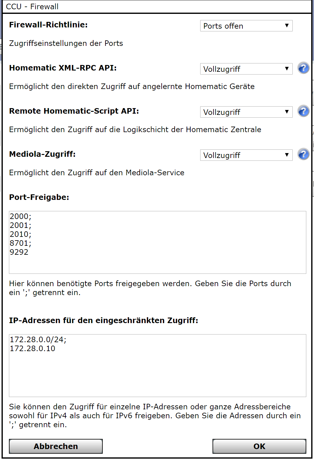

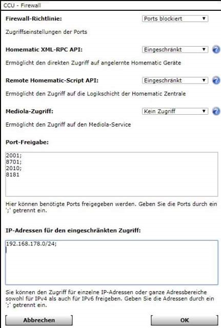

the following securtity settings are configured.
After updating CCU3 firmware to 3.41.7 I have no connection between openhab 2.3.0 (openhabian on raspi, Homematic binding 2.3.0). I have the same problem and errors on my log as you. I tried disabling all security things and opened all ports listed on the open hab docs for Homematic binding:

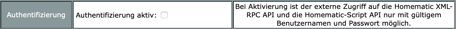

I disabled authentication for RPC:

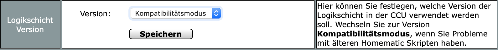

And I switched to old compatibility logic layer on CCU3:
After every change I rebooted CCU and openhabian.
The links of ptweety did not help me.
Please help my smart home does not work since two days!

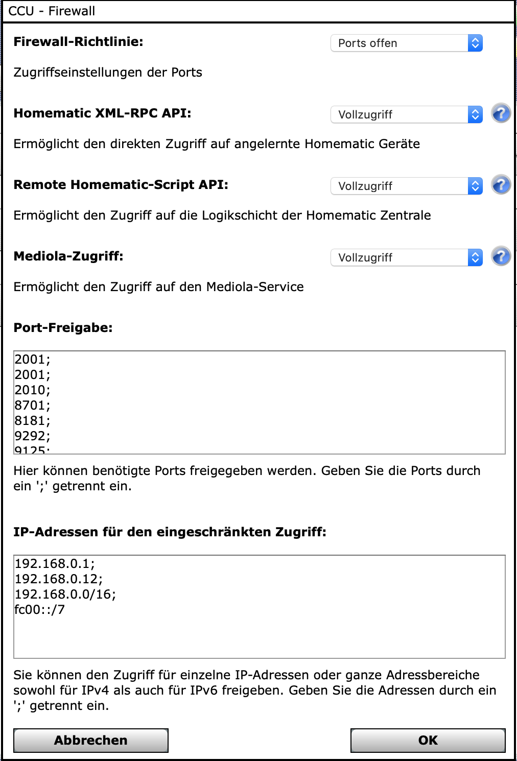

Either you can install the old firmware or you can try to change the ports for the Bridge Thing.
I got the same result of netstat -nultp as ComJack85. Maybe the developer of the binding could know something.
I changed the ports, but get this error.

Did you change any ports? Please undo and set your ccu like this
You have to change the IP adress to yours. If you are using also wired components, you also have to add port 2000
I am not sure if there is a need to add port 9125 too, but you can try

Hi all, I had the same Problem. Upgrade my 2.4 Version of Openhab to 2.5 Build 1415. with the Nightly build I was able to connect to my ccu3 but the Cuxd created devices are not listed/found. Do you have a fix?
Thx and Kind regards
Chris
Cuxd is using port 8701. Did you listed it in CCU settings?
