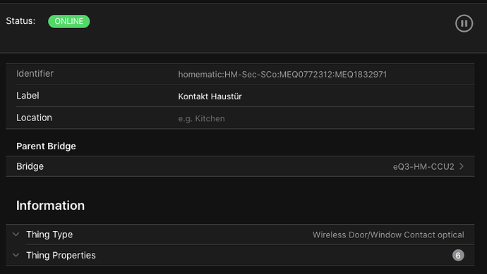

Hi and good morning,
the device is a (but no contact HM & HM IP gets an update):
2 channels linked:
The trace file:
openhab.log Homematic Trace.txt (15.1 KB)
I hope this helps to find it.
Best regards
Stefan

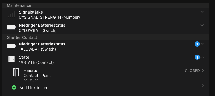

The problem reoccurs as soon as you add a MAP Profile to the thing/item link!
State is not updating.
Unlink the contact, relink. (only way to get rid of the profile)
Working again.
Hold on… if the channel is of contact type, then it will send states OPEN/CLOSED. If an Item is of Contact type,it will only accept states OPEN/CLOSED.
What is your MAP trying to do? If you are trying to set your Contact Item to anything other than OPEN/CLOSED, it is never going to work.
The MAP is trying to translate it.
I hope to use it like:
But then the thing/item-MAP can not be used, right?
Anyway the state of the item was not changing, even for the items withoug channel/item-MAP. Now after unlink, readd, a.s.o. it is changing state again.
A Contact Item state can only be OPEN/CLOSED, but you can show that how you like in a UI by using a MAP on the state presentation.
