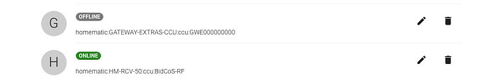

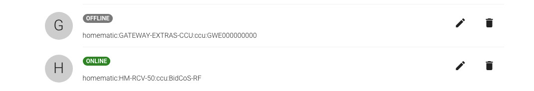

@jjk please post a picture of your Gateway-Extras thing from paperUI. And maybe look in the log if there is a something which hints to the gateway initialization.
@Josar, a pic is attached.
I’ve tried to find a hint in the trace log, but I couldn’t find anything (although the amount of trace info is huge, so I might have missed something…)
