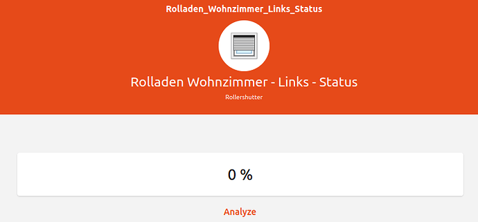

I’m using @Bredmich’s trick to get my HomematicIP Rollershutters (HmIP-BROLL) to work. Overall this works perfectly well. :slight_smile:
Although the Status-Item perfectly shows the opening in %…

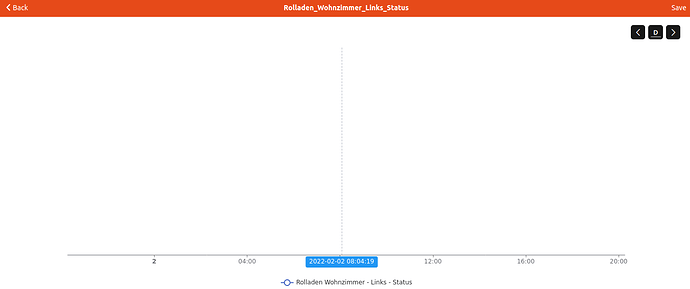

… the graph (via “analyze”, which I use to check how my shading program behaved) is completely empty:
My first reaction was “maybe there’s a senseful state description missing”, but looking at the log, the values are already simple integer values, so they should be logged?
Am I missing something?

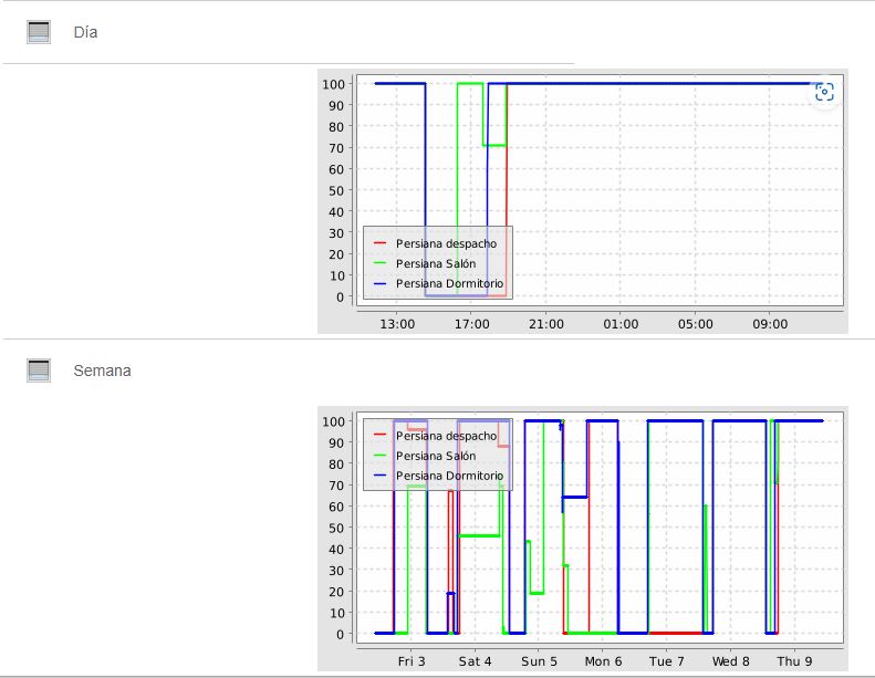

I can also see the graph in the Basic UI

The relevant group is g_Persianas and the items are PersianaSalon, PersianaDespacho and PersianaDormitorio
Nope, unfortunately not.
Let me know if you find something.
Update: I did find a solution: Homematic HmIP-BROLL & HmIP-FROLL - Get them to work in openHAB - #11 by Cplant
As this problem already persists longer, I‘ve added a ticket for this:
https://github.com/openhab/openhab-webui/issues/2876
