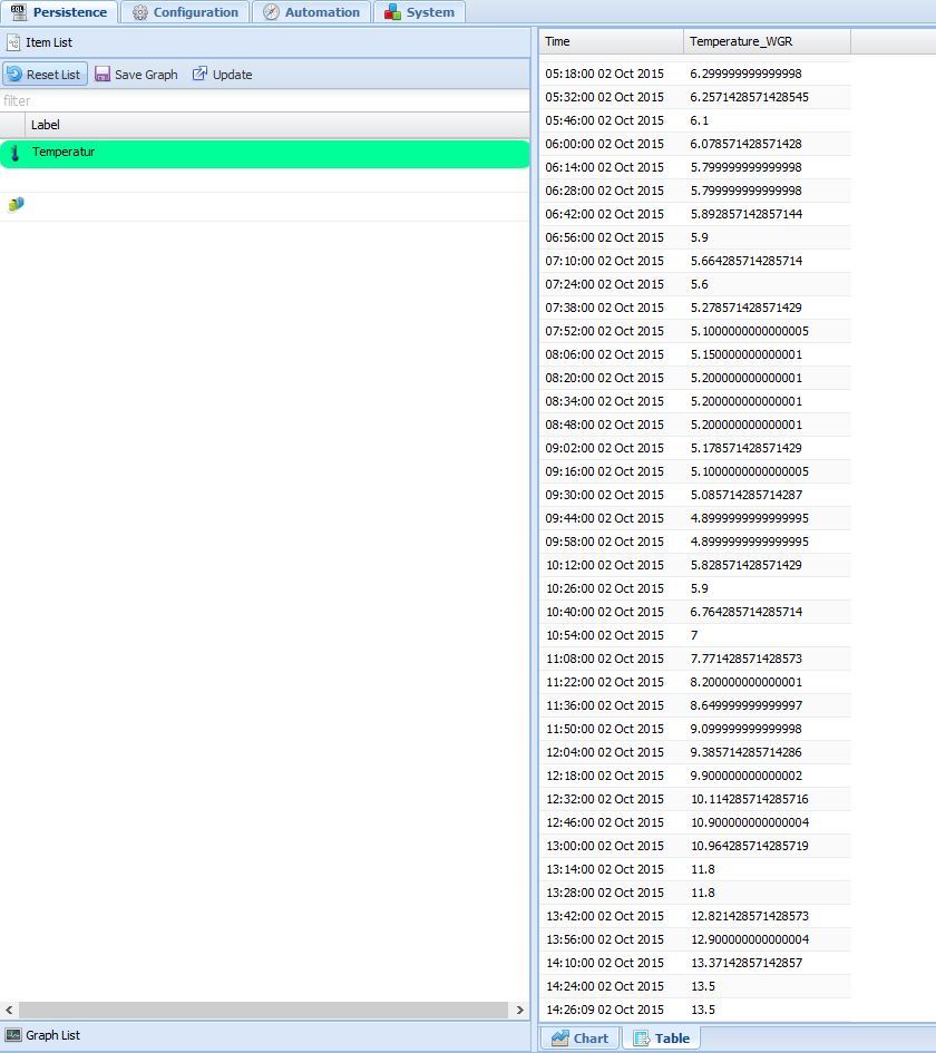

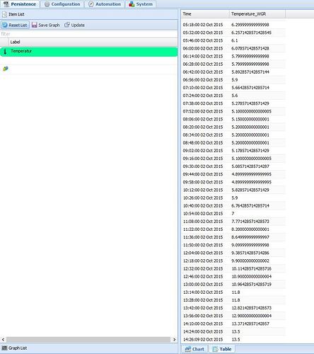

Habmin is a bit tricky at this point: supposed your setup is correct and data are stored, you need to go to the persistence tab, under “Label” you should see your persisted switches, contacts or whatever, highlight one with your mouse, click on update, go to the right hand side of the screen, click on chart (at the bottom), then click on table … at least NOW you should see your data.
If you can’t see anything under “Labels” your setup is wrong.
Good luck.
